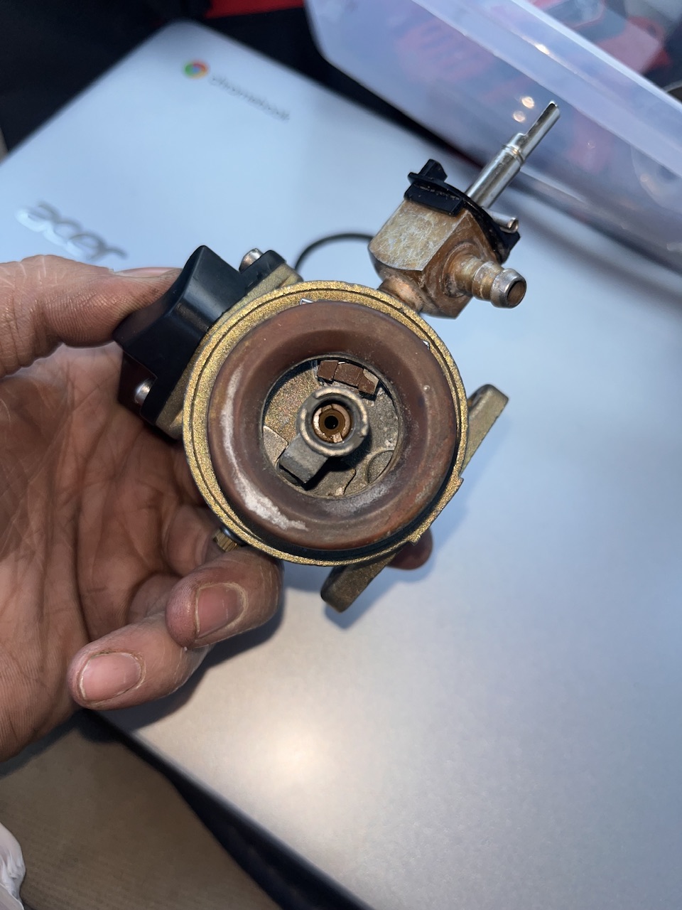

I just bought a small 14 ft John boat yesterday and the motor came with it, I took the carb off already and it had water in it. I cleaned it out and it is much better now but the bowl screw is broken. I might be able to just toss a new screw on and that would most likely work I just want to weigh my options. Also I am located in Milwaukee Metro area of Wisconsin.

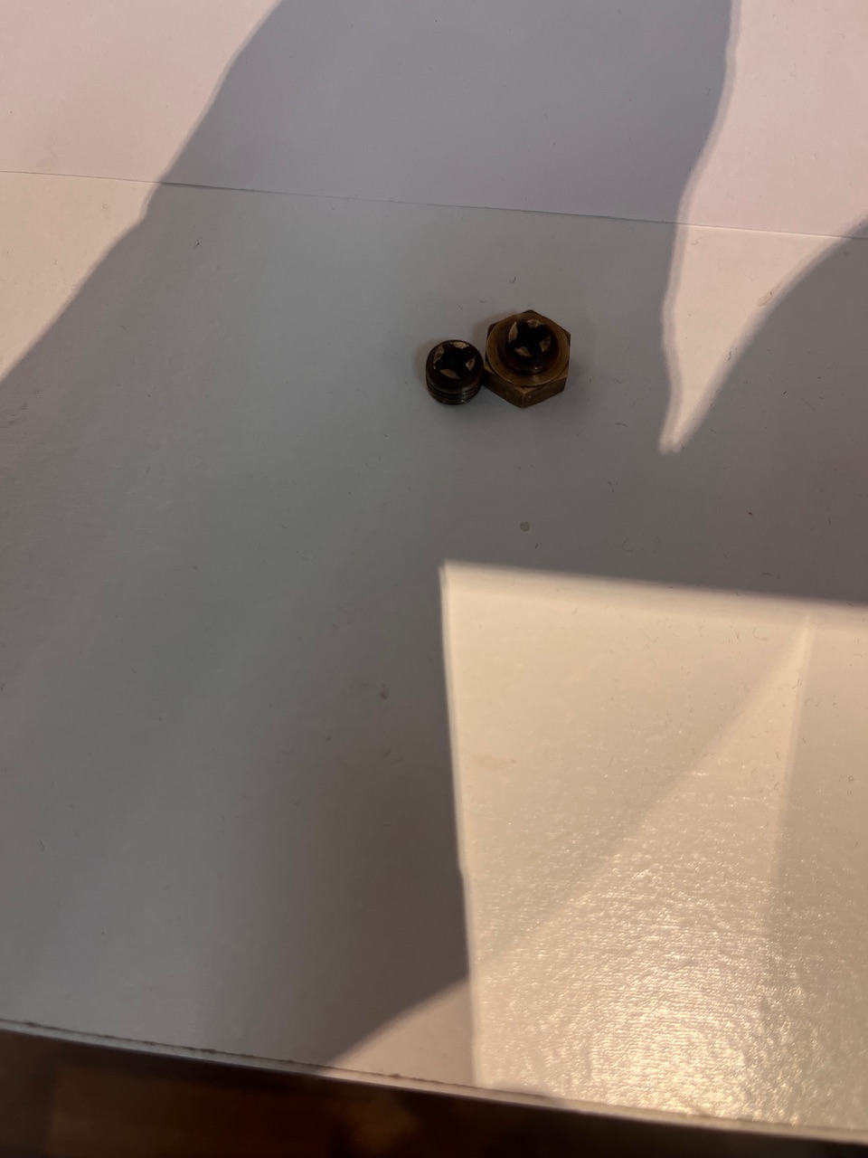

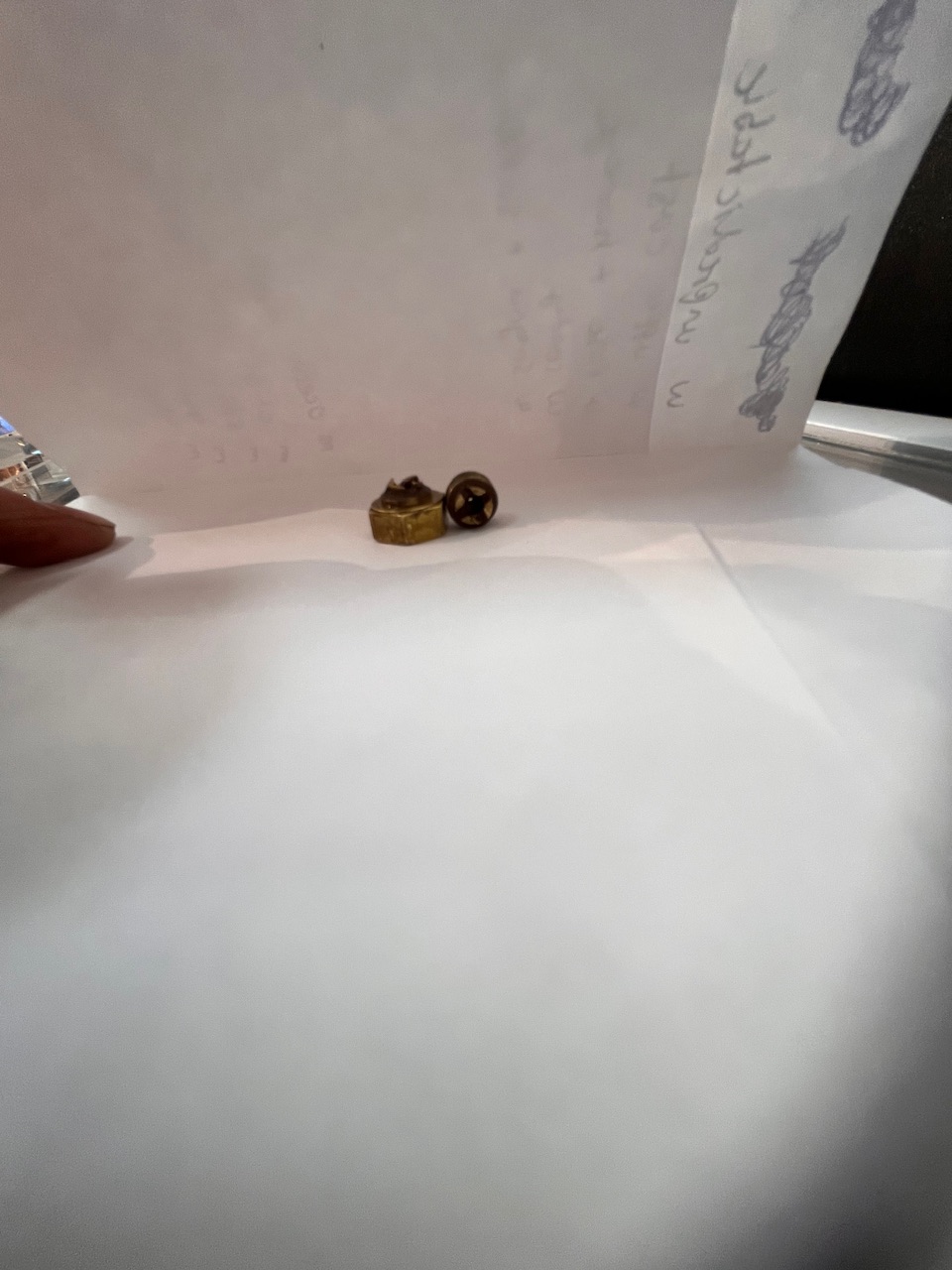

Yes the bolt just broke off at the fluid holes for the banjo style screw, would just a regular SS screw work to replace this?
A banjo fitting is designed to pass fluid through. Often there is a hole drilled through the bolt, to let fluid continue on its path.
Post a photo of the bolt.

Not positive?? but the bolt screw could also be a jet?? Maybe??

I am kinda thinking that same thing, I just haven’t been able to find any original specs for the screw. I might try and find one that looks similar on Amazon or somewhere similar and see if it works

I found out the thread pitch is 5/16”-24, now I just haven’t to try and find a screw with the same pitch
I could possibly make a screw withe the pitch of M8-1.0 work it just might be a little tight
Do not try yo use a metric bolt into an SAE fitting.
