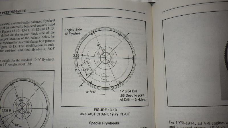

Thought i would post this for future reference..
This is for chrysler 318 and 340 to a chrysler 360.
Note :there a a couple years of 340's that are exrenaly balanced so be sure it is nueraly balanced before doing this.
If you have an internal (or neutral) balance flywheel, you can also drill it to
make it an external balance flywheel, like so...

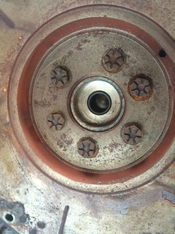

Examples only
Post #15 shows a diagram for balancing a neutral flywheel for use with a cast 340 crankshaft, not a cast 360 crankshaft.
It looks like Chrysler uses a non symmetrical bolt pattern on the 318 engine flywheels as seen here.

The amount of imbalance added to a neutral balance plate for a 360 …..

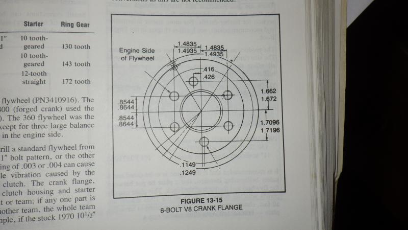

The crank flange BC (less the Hemi)...……..
