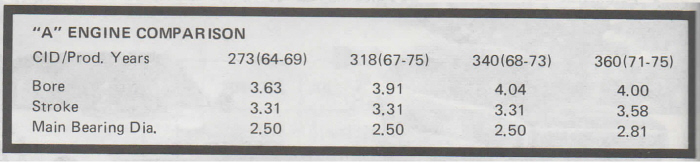

And head CC and port. Small port 273 & 318, Large port 340 & 360. Small port have 60CC chamber and large port heads have a 68 or 70 CC chamber.The intake of 318s and 360s are interchangable. The only real difference is in their flywheels, damper pulleys, and oil pans.

I doubt it. The 273 was built from 1964-69 and the 360 was not made until 1971. Plus it would of required a very special pi$tonSomeone once told me (on this forum again someplace) that the marine 273 uses 360 heads? True?

Main bearing diameters on the 360 are larger than 273, 318 , and 340. Hence the need for the change in oil pans. The balancing difference most likely due to the use of cast cranks in the 360 as opposed to forged steel in the older small blocks. All the cast crank parts would need to stay together as an assembly.
360 heads could bolt up to the 273 but the larger valves might require a notch in the block deck for clearance. Not worth the trouble.
360 heads and intake on a 318 should work with no mods except maybe plugging air holes next to the exhaust ports.
360 heads on a stock 318 give you about 7:1 compression.
