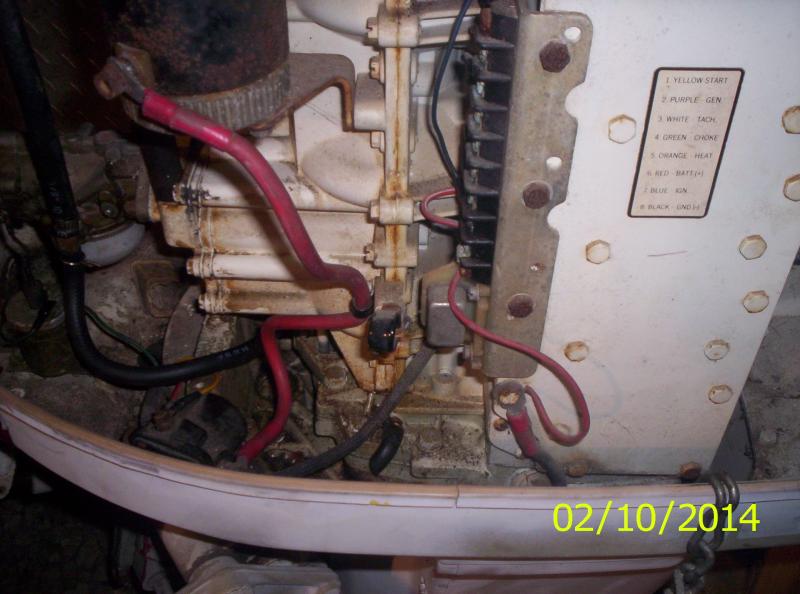

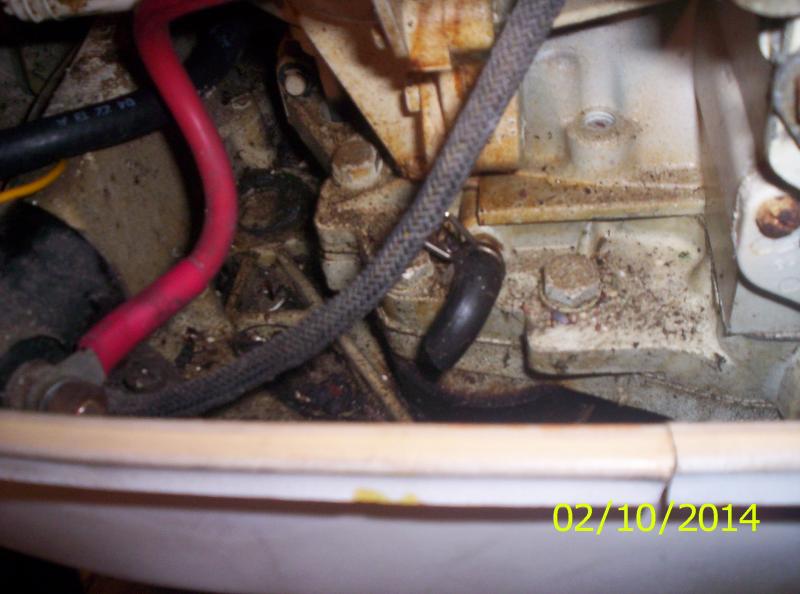

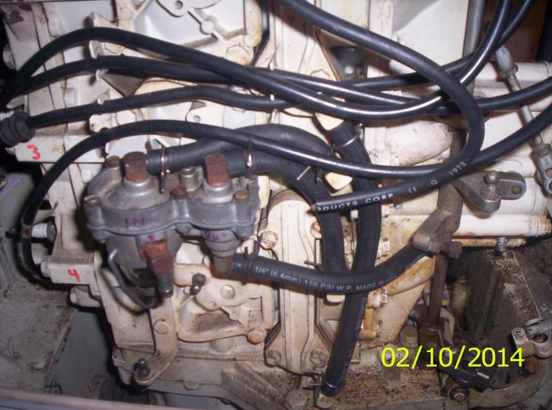

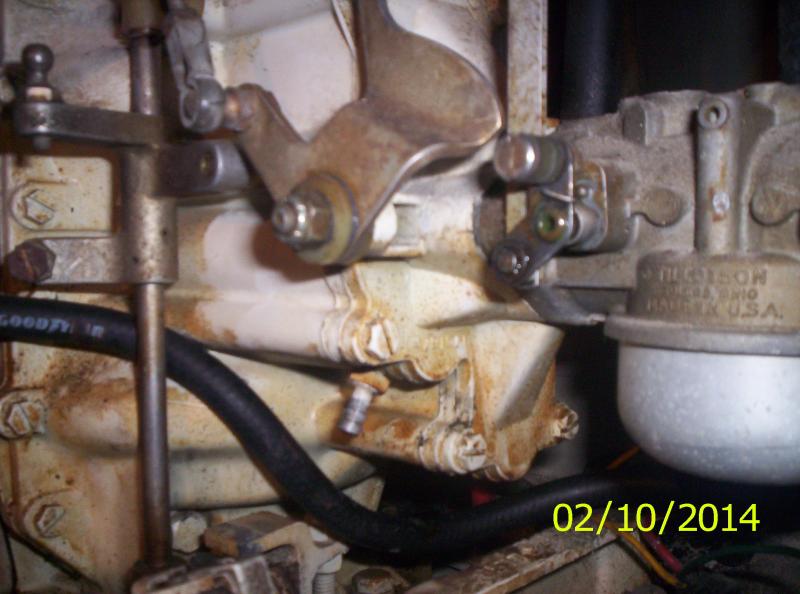

hi new to site. behind reed valves there are 2 hoses . where are they supposed to hook to? starboard side! also 1 hose on port side where power head bolts mid unit. where is it supposed to hook to? any help would be great. I got motor free.

The pump is the older style and it looks like it's right.
The small nipples sticking out(pointing down) I think the hook to the piece of hose on the other side of the block under the starter.
Thanks for your reply jerry. Are you saying the two nipples behind reed valves should both be hooked to nipple under starter with a tee fitting?
Thanks for directing me to hopefully some more answers on I boats.com .
Yea I think that's where it goes.
