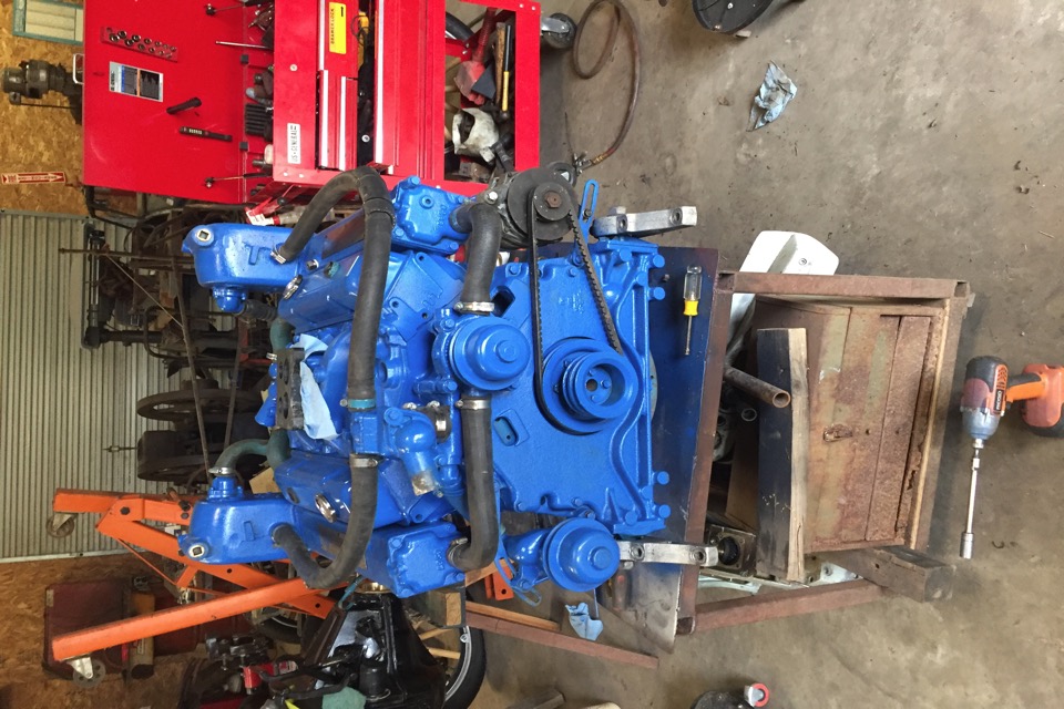

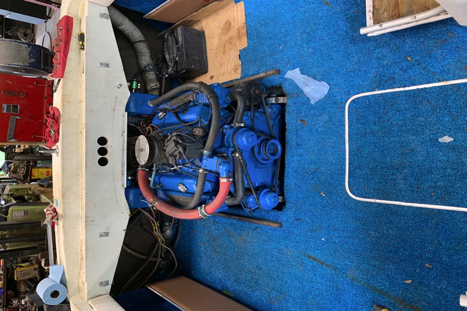

Here are some pics to see what I have. I tried to turn the pics so that they are not on their side but for what ever reason it didn't work Flywheel is facing forward. I do have the AQ series adapter. I do not have any pics of that. I did call Arco on my search for a HTGR Starter CCW and they said that they would have to call me back. He did not see one right off. the guy on the phone was super nice and was going to do some research.
I'd like to have a few private words with the engineers that designed this engine package!
