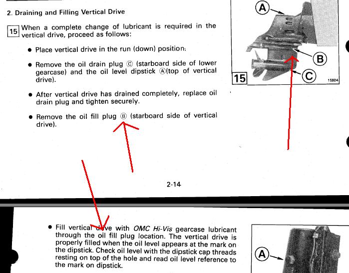

I put a 230 OMC engine in my boat and reattached the drive and lower unit. I have spark and fuel.You can see fuel squirting in the carb. Carb gasket leaks. Im gonna replace it. Engine will fire if I dump lots of gas in the carb. But any way I do not own a manual. I need to know about checking the oil in my cobra drive and lower unit.
