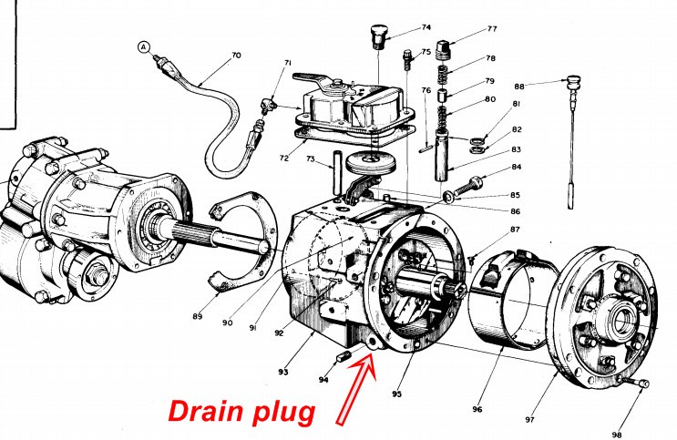

Use the drain plug to get all of it out.
There's also a drain plug on port side of the transfer case. It's located at just about the lowest point. You'll get barely half a quart out of it.
-JJ
