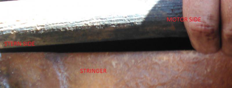

Thanks Jeff and Mako Mark. I need some advise on this measurement to make sure that I don't need the 4" risers, which may fit my installation. I am not sure if the original engine had risers or not, but if it did, it must have been the 4" because there is no way 8" will work. When you say the "engine's outlet" are you talking about the height of the middle of manifold exhaust port or the height of the middle of the exhaust after the 980068 elbow is installed? Also when you mention the "thru hull", is that referring to the thru hull that lets the exhaust out the back of the boat? What is the number of inches per foot drop or angle or whatever benchmark used to determine the need for a riser.
So I bolted up the elbow directly on the manifold to try and get an eyeball on the angle of the dangle between the muffler and the elbow. i put a stick in the muffler on stern side of the exhaust and the elbow as you can see in the attached picture. The motor side still needs to come up 2 or 3 inches still to get the transmission/shaft coupling to line up, so in the end the motor side will be even higher. You can see the motor is still a good bit higher than the muffler even without the 2-3 inch lift I still have to put in. I believe the muffler is even higher than the thru hull, but I still have to check. What do you guys think about going without risers in this install? I am in the Bahamas, so everything has to be shipped and there's no mechanics except me and my friends.
The pic posted appears to be cropped and doesn't show the detail you described....
I screwed up in my earlier post regarding critical dimensions....guess memory isn't always best....Anyhow, the critical dimension is from the top of the elbow to the waterline. Usually measured using the transom/gunwale as a reference point...easier said than done if the boat is in the water....the crusader spec is 12" (though mercruiser says 13" in their older manual)...
The other item is to have a constant drop to ensure the water drains out....they have other recommendations but many are hull specific.
As far as omitting the risers, that's your decision....same applies for deviating from any other OEM requirement...as long as you know the risks associated with the decision, and you're aware of the consequences, follow your gut...
Like all of these "rules of thumb, it all depends upon circumstances. My stock Pursuit 3000 flunked the survey because the drop from the elbow did not meet "standards". But I never have had a problem. But then again I rarely back down on a big fish (and never into a heavy following sea)....and maybe I do have the recommended 12", I have forgotten. I think the real rule for elbows is "the higher the better". But if you pay attention to your engine rpm and the following seas you may avoid problems that others with the same setup incur.
