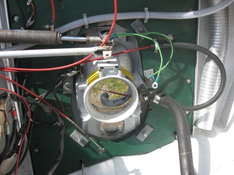

Here is what is attached. I would worry about your exhaust for corrosion. Mine is fresh water and was almost gone around the exhaust mounting flange due to the diesel fuel and electrolysis corrosion. Make sure your grounds are in great shape while you have it apart. If you have a drive and transom shield from a AD31 then the gear ratio would be the same and your old A props should fit as well. You could try and do the swap with engine in. If the engine is easy to lift out then my vote would be to pull it and do a complete re-install after everything is cleaned up and repainted.
