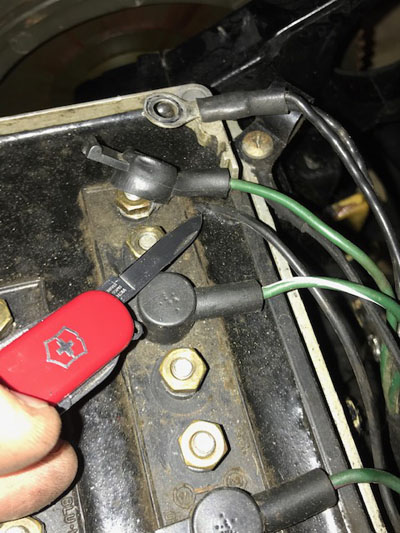

Two odd things stand out: The switchbox says "WHT-BLK" where the bottom-most wire from the trigger hooks up. On the trigger I stripped from my parts motor, that wire is definitely YELLOW and BLACK. The same shade of yellow as the solid yellow wire that is connected above it. And on the trigger I replaced, that wire was solid black. The other thing that I noticed that the switchbox on my parts motor has a black wire coming out of the sealed interior of the switchbox that was grounded. The switchbox on my new motor does not have that wire, but every corner of it is grounded. Both are pictured below.

I can easily move over the switchbox. I didn't even think to do that because the two motors are identical right down to the model number. I even had the box from the parts motor off and in my hand, because the stator and trigger wires were routed behind it. But it's not defective, the motor has been running, just suddenly won't start since I swapped out the parts I listed above.
