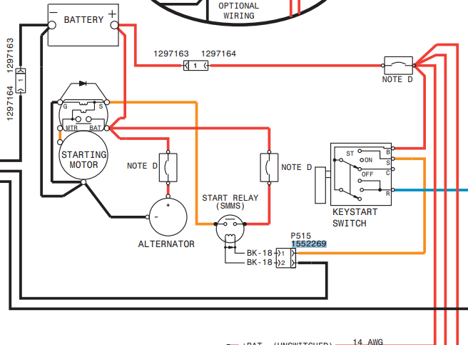

Hey guys. I have a dual CAT C18 setup in my 62S Azimut and I just starting experiencing an issue with the port side engine. I turn the key and hit the start button and nothing. No noise at all. Voltage at the battery and across the Alternator is good. No voltage to the solenoid when the start is pushed which is what I assume is the problem. The engine was starting a couple days ago no issues, no I assume its something easy/electrical. I have a ZF Marine propulsion control system which has a start interlock system checking for 24v, a control station, in neutral. Since I have two controllers I have verified the port side controller is good which started the starboard engine. Only thing I can think of is that the yellow/red cable running from the controller to the solenoid (I think its NO) is not being passed as there is a break in the cable from the controller to the solenoid. Does anyone have any other ideas I can check? I verified a strong ground to the engine as well. Or at the very least a way to start the engine so I can verify she is still good? Unfortunately I dont have the keys to the maintenance panel or I would try that...
