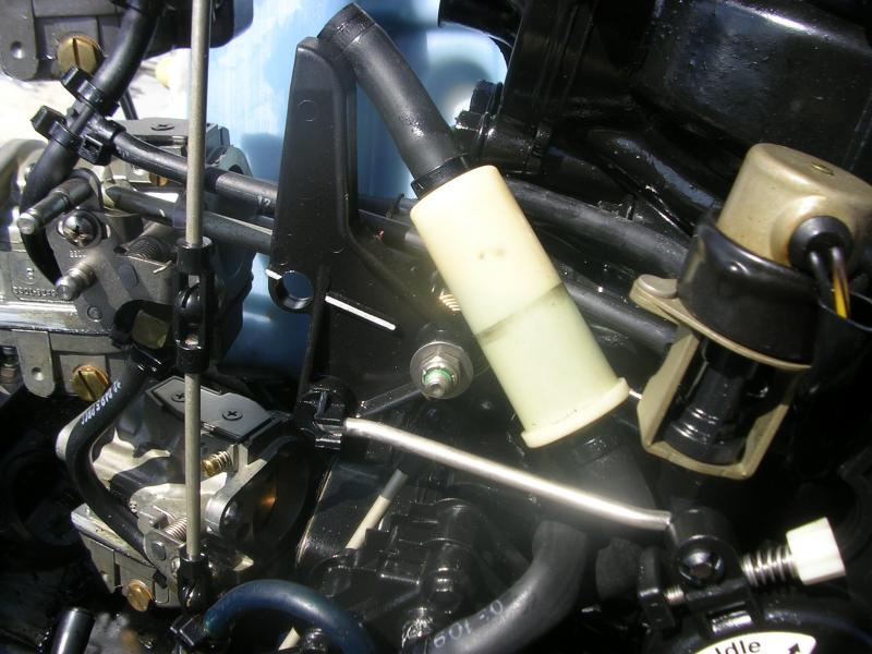

While I was removing my carbs a piece of plasitc broke off what appears to be a linkage plate. The white line going across the black piece behind the fuel filter is what I,m talking about. does anyone have any idea what the thing hooks up to (or does it hook up to anything) the piece was lost so I dont even know what it looks like and I cant find a pic in the seloc man. that helps at all. this is a 96 75 hp 3cyl 2 stroke model#0g395022

It is the throttle cam it hooks to that arm on the bottom.------------There is nothing that goes in the hole at the white line.---------------The plate touches a roller that in turn opens carburetors and operates adjusting arm for oil injection.-----------Just looked at a 3 cylinder in my yard .
Thanks racerone, theres a linkage conection of some sort right in front of the hole and I was concerned that a piece had broken off that was supossed to attatch to it.
