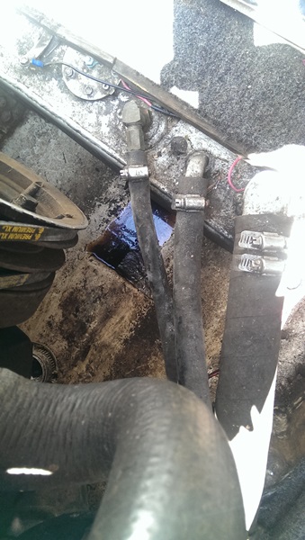

So off of my tank I have 3 outlets.
fuel filler
fuel vent
fuel delivery
I have a clear fuel filter on it so I can see it getting fuel. The filter was horizontal, so I think it might have been getting air and then fuel and then air again, causing the surge in running. I realigned the fuel filter to be horizontal last night and test running it today to see if that was the problem.
I have attached at picture of the before the filter, which line would have the check valve in it and how do you check to see if it is stuck?

You might also check your vent line from being plugged or fuel in a low spot. As you state, it's starts to act up after running a bit. If that vent line is plugged, you might be vapor locking the fuel system?
remove it and try and blow thru it from the tank side. replace with a barbed fitting FOR TESTING or use a remote tank
I am so new to this. I will look to see where the vent tube goes, not really sure where it ends up.
I will also blow some air through the check valve and see what that shows me.
I do have several extra tanks, so I could use one of those also to see if it takes care of the problem.

So I blew out the check valve and the breather tube. I changed my fuel filter to be mounted vertically instead of horizontally.
The boat ran much better, got up and ran hard.
