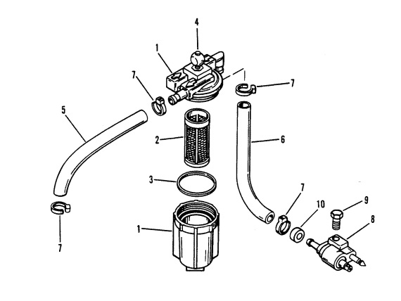

i unscrewed the cover of the fuel filter, at least thats what i think it is. its plastic reservoir with a filter/screen on the inside. the fuel line goes into the top of it and then goes out of it into the carb. it was full of gas. however, i tightened it as much as i possibly could but it now bubbles when i squeeze the fuel ball. i didnt see a gasket, not sure what to do about that.

what about the fuel filter? i took it apart again and cleaned it all up and put it back together and it still spits and bubbles when i pressurize it with the fuel ball.

You probably lost the flat (o-ring) washer that goes with the fuel filter and now you are sucking lots of air which could account for your issues.
There is a little rubber washer that goes on the rim of the (cup) of the fuel filter. It falls off every time you unscrew the fuel filter. It's kinda a dull red in colour and you can never find it if it hits the ground (No, I have done this a few dozen times myself over the years :)).
It's #3 in the diagram below - merc part 25-897536 (they call it a "fuel filter seal"), costs a little under 2 bucks (I have about half a dozen spares hangin' in my shop).
