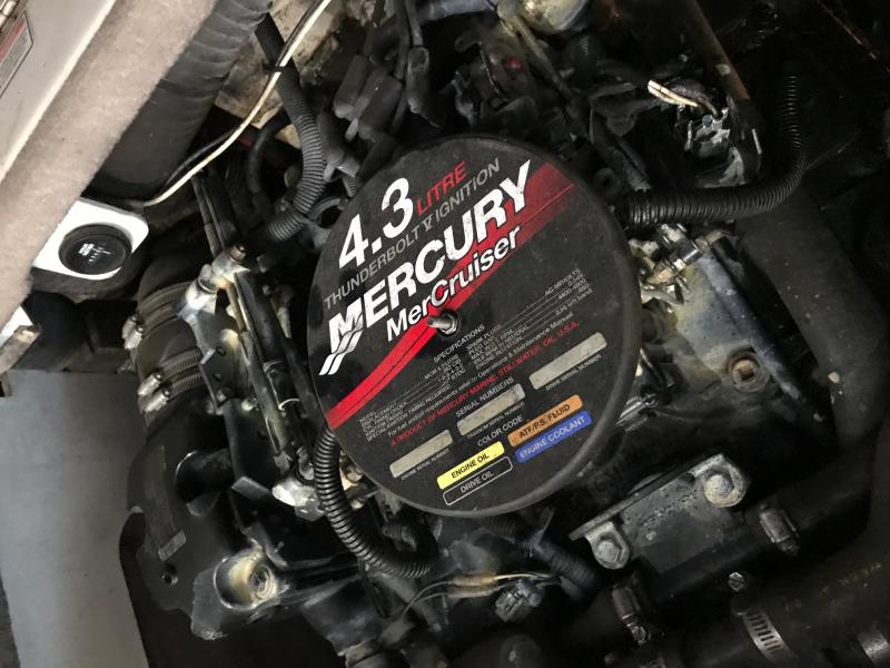

I have a 2003 Mercrusier 4.3L that has no serial number. I am trying to replace the exhaust manifold. The part showing up in all the parts diagrams doesn't match the one on the engine.
Am I just plain dumb?
Either of those manifolds will work. Barr is one of the better aftermarket ones, I think generally well regarded vs some cheap junk out there
Had some very good service ( 9 seasons, May to Nov, in seawater with only occasional fresh water flushing) out of the OEM dryjoints on my MERC... Elbows still in VERY servicable condition when I replaced them.
