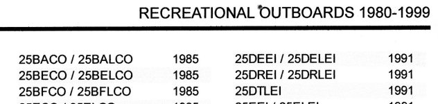

It's on the list. 1985. "BJ" simply means a Johnson made in Belgium. Ignore the "S" at the end.
