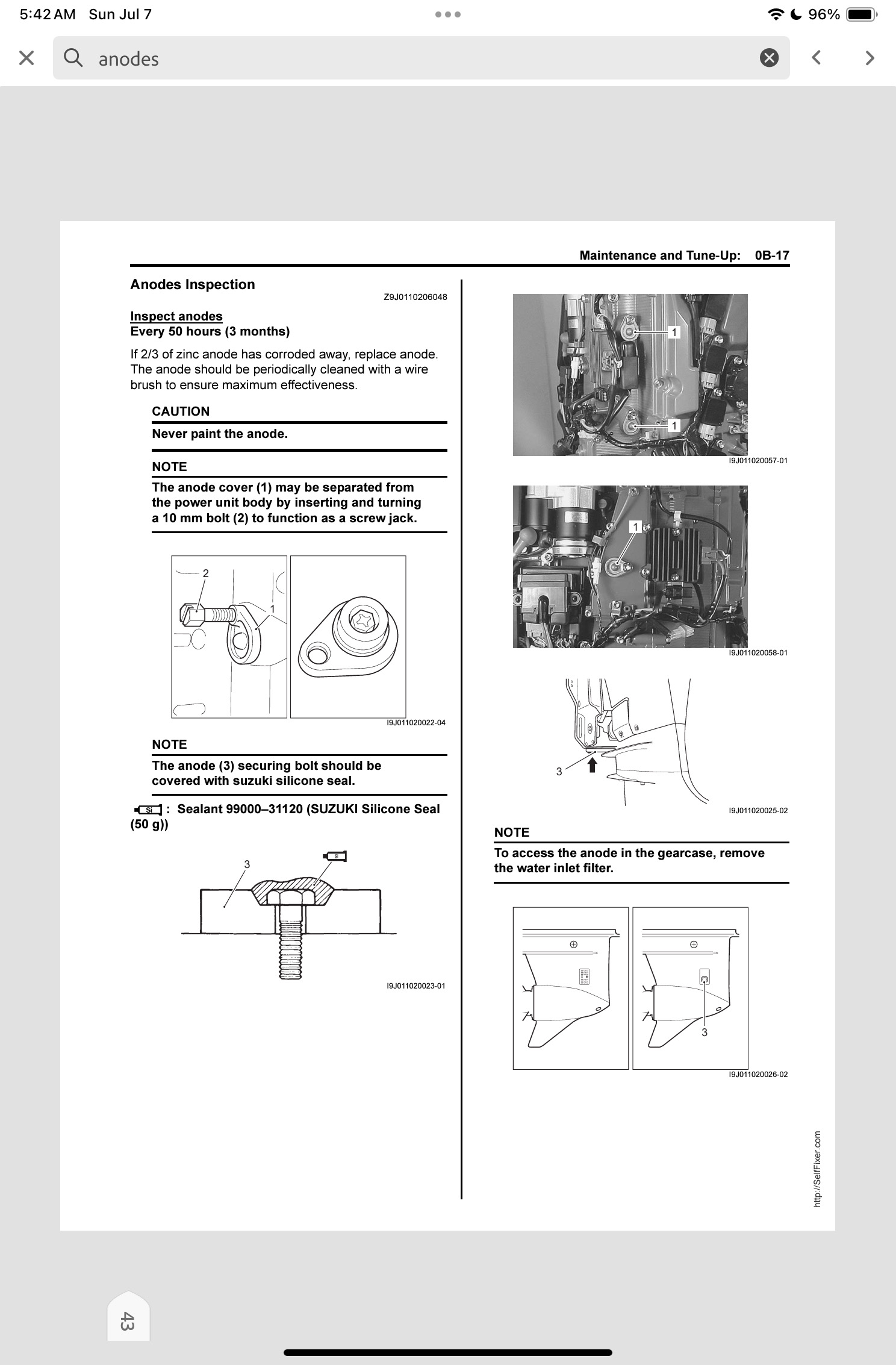

Thanks, will check to see if my are located at the same place.Selffixer.com has a service manual for your boat in pdf form for $10, it will have the locations. The screenshot below is for a 2009 DF90A. I’d guess your’s will be similar.
