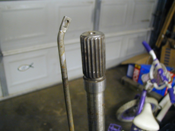

I am use to older (70's and 80's) omc 3 cyinders. This lower unit looks very similar to OMC. It has a 20 spline drive shaft (as opposed to the 4 spline on my OMC) but a 13 spline output shaft that will accept an OMC prop. The shift rod has a kick instead of an offset like my OMC. I had a Suzuki once and I believe the prop on it was the same. The shift rod cover seems to be larger than OMC and it has an exhaust coupling/extension (not shown) of some sort I do not remember seeing. I will post this in Suzuki and OMC forums hoping someone can ID it. I googled some casting #'s off the unit housing and water pump but nothing came up. How can I positivly make an ID it?

omc does have a 'fine' and a coarse d shaft spline,cant rem the count....and i am thinking that the shift rod is turned backwards...
i have never touched a 'suzuki',but if i had to make a quick decision ,i'd say omc fr everything i see,and think the skeg,has had some mods.
