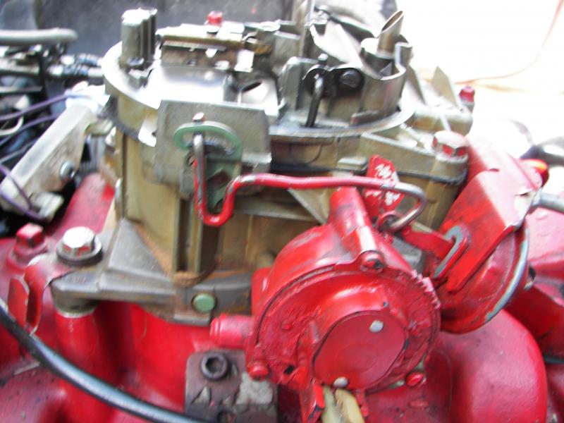

2.... The AQ 260 used the Rochester Quadrajet carburetor.
images
Can you post photos of your carburetor?
I have some photos , my daughter will be assisting me with photos soon. Regarding the carb, like the photo Kim provided and the one in my in my Clymer Manual, mine does not have the "U" shaped return tube on top. Thanks so much for the help I will get the photos on soon along with ones of the distributor.
Some of the Q-jets used the "J" tube, some did not.
Of the Q-jets that did not have the "J" tube, the front area ahead of the vent tube is "diked", for lack of a better term.
Also note the back-angle cut to the vent tube.

Ray, the photos come through on my end just fine.
The carburetor appears to be correct for this engine.
I'm not familiar with this ACCEL HEI Super Coil #140003 ignition system.
I'm also not familiar with seeing the spring-load distributor cap hold-down. Most all Marine Ignition system caps are screw-down.
When I do a search, I come up with automotive applications only.
If I were you, I'd research this to make sure that it is Marine approved, and that the curve is correct.
Wrong curve = no performance.
Wrong and excessive curve/TA = engine damage.
I also see what appears to be the ballast resistor still in use.
BTW, you'll be looking for an advance curve similar to this.
