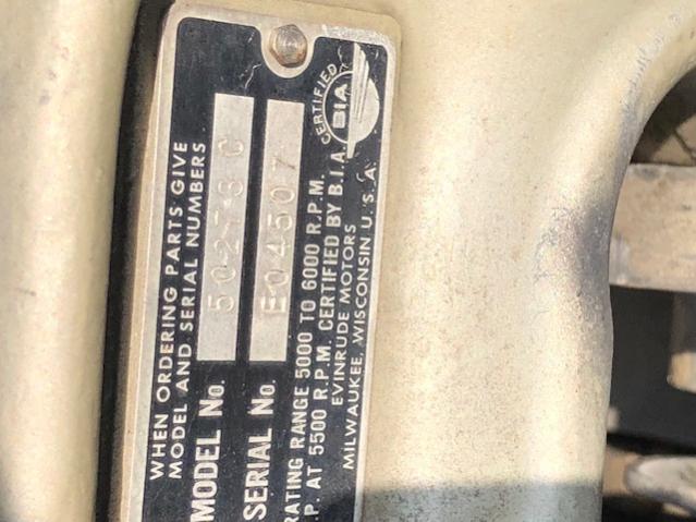

I recently acquired my first boat. It is a 1989 star line, and it has what I believe to be a 1972 evinrude 55 outboard on it. Took it to the lake yesterday and everything was going good until I realized I couldn’t get it out of Forward, i could push the neutral and reverse buttons, but the prop keeps spinning forward.
