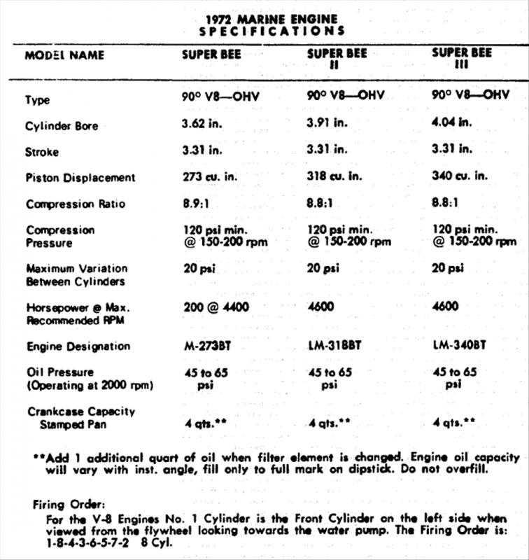

Maybe some spec sheets can help.
Confirm the rotation (std / rev)
"Crane hydrolic roller rockers"
Are they 1.5 or 1.6 ratio rockers?
"and the rest is stock"
Try to get all of the "changed" parts identified with part numbers and make a list.
