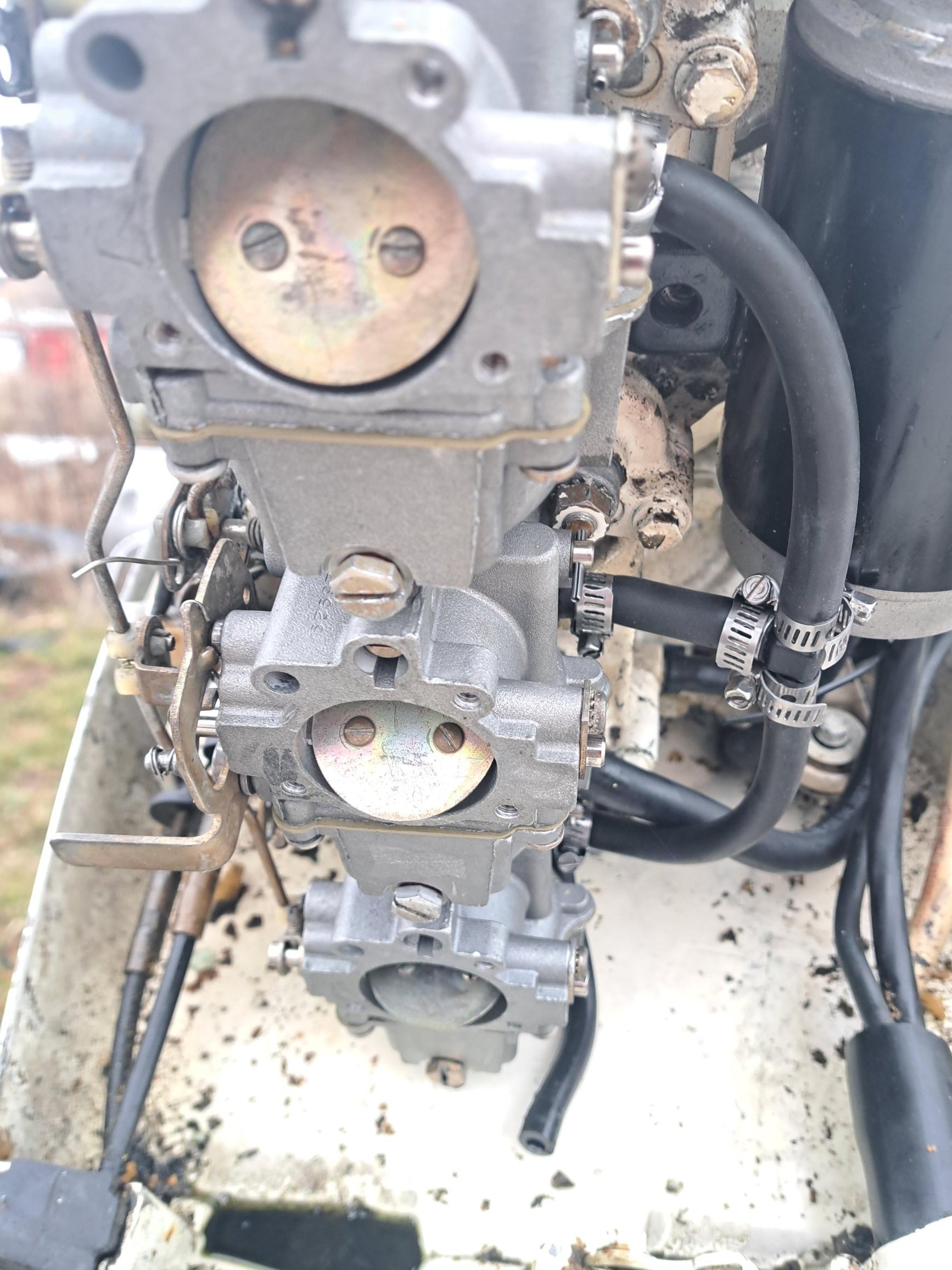

I made it out there today figured the faster i get the easier it may be to get help with the issue
Looks like the adjusting / lock screw on upper and lower choke shaft need to be adjusted.----No idea why anyone would loosen those.
K know in looking at it like this so noticing the bottom carb is open the middle is about 1/2 open an top is like 1/8 from being shut And i have no idea either But i just want to say thank you in advance for all the information you are providing me i really appreciate it
also looking at it further there is no screw for adjustment on the middle carb thats why you said top and bottom
Good luck with this easy fix.
Thank you i appreciate the help and i wont be doing it for a bit but just wanted info on how to do it so i can stop depending on others to help n them not doing it right but it is the screw on the top and bottom at the front were there is a bar from mid to top n mid to bottom am i correct on this
well..ya can pay travel expenses for someone here to have a look...30 second fix....don't know what else there is to do for you..
wow just asked a question hoping to get info on how to fix something but i guess that's to much to ask for in here so u say its a 30 second fix my question is why is no one helping me with info on how to do it
We have. Read post #12 and #25 again. Look at what moves the butterflies when someone advances the throttle. It will be obvious what parts move.
Two of yours currently move…look at what makes them move. Then tighten the fitting in the one that doesn’t move, making it in synch with the others. It really cannot be simplified anymore.
