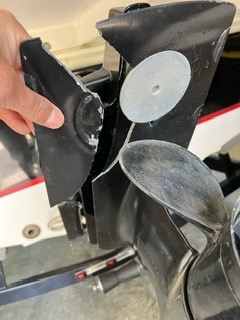

Dolphin Fin put to much pressure where it was mounted and broke piece off. Can I still run without it and is it practical to have it welded back on.
Here is pic of damage
Had the same thing happen for the same reason on my gen 1. I ran mine with a slightly smaller chunk out for a few years and found that I got cavitation putting/ burns on the prop.
I JB welded some aluminum plate on underside of plate , faired it in with jb weld worked ok for a hillbilly repair. Proper way is to have it welded.
