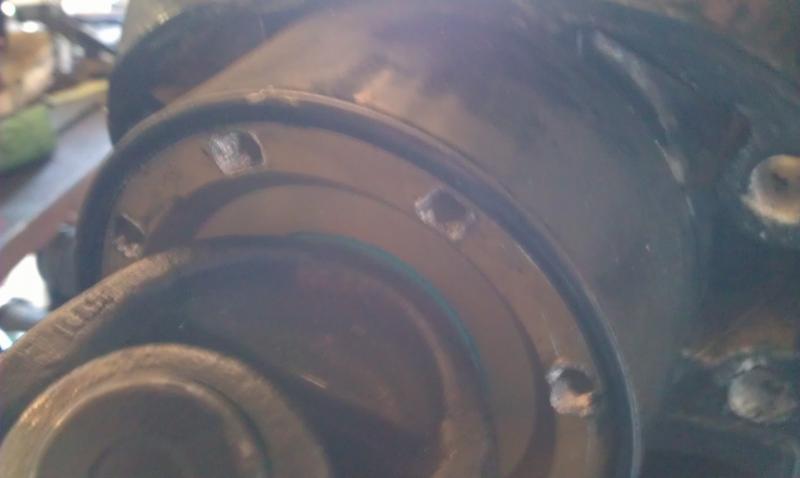

My mechanic obviously doesn't have right tool :(
Re: Wow!
Spanner Wrench For L-18 U-joint Bearing Retainer 91-862219.
Replacement Pin Set For L-18 Spanner Wrench 91-862218.
http://boatinfo.no/lib/mercruiser/manuals/mercruiser28/pages/page_h104.swf
http://boatinfo.no/lib/mercruiser/manuals/mercruiser28/pages/page_l122.swf
When or if he puts the drive back together, make sure that they use the Torque Conversion Chart for the U-Joint retainer nut tool in the service manual and not just torque the retainer nut down to 200 lb ft.:eek:
Mercruiser service manual #28, Part number 90-8631601.
Good luck.:)
thank you, I need luck. Well, this is definitely last job that I gave to this Mechanic. Be aware, he is authorised for Merc. @Chris (Dockside Marine Services) I have found that, using above mentioned tool, there was about 10 milimeters less "push" for the cable when I insert forward. I will recheck after mounting the drive back.
