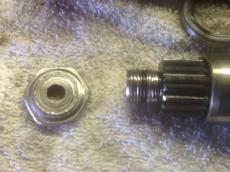

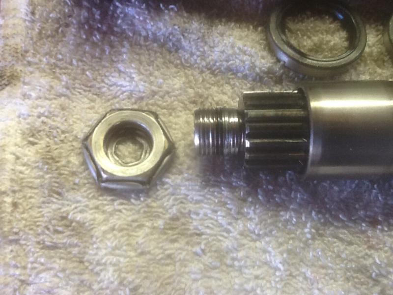

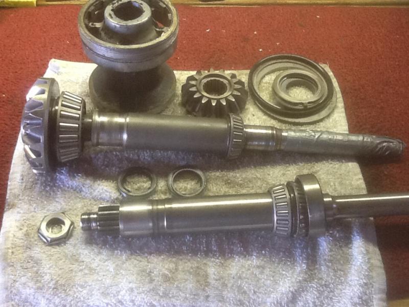

After pulling it apart, I found the vertical shaft nut on the bottom of the shaft had come loose and stripped off the shaft. This allowed for enough movement to destroy the bearings, races, but fortunately, it looks like the gears and bearing carrier look good.
You can see the nut is knurled over.
The backside of the same nut.
The complete assembly, with gears that look okay. Time to order the lower unit replacement kit.

I found an old Service Bulletin, 92-3 that discusses an issue with the pinion nut coming loose.
"A. BRAVO LOWER GEAR HOUSING PINION NUT Models
All Bravo One / Bravo Two Drives
Changes
The pinion nut has been changed from an elastic stop nut to a non locking type nut, The new nut requires the use of type “A” (271) loctite.
Problem
There have been a few cases in the field that the pinion nut threads would strip out at torque value or just before torque value was reached when the nut was reused.
Parts Required
(1) pinion nut 11-20739 (.750-16) 1 1/8 diameter.
Repair
When rebuilding a gear case assembly replace the pinion nut with a new type nut (11-20739) and use loctite “A” (271) on the threads of the nut before installing. This nut requires the same torque value as the old nut,(120-125 lb.ft.)(163-170 N.m). "
Might be the reason mine came apart.
