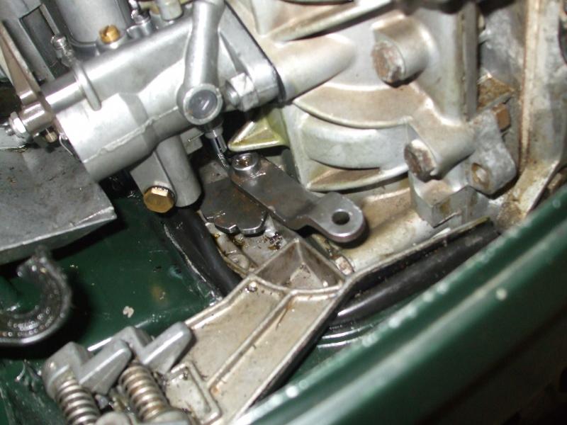

This is what I have tryed as of today If you look at line #8 the pic shows the shaft to the cables.I have put it in both positons like it would be if you put it in F or R I have moved the shift shaft with the white cam piece out.and moved it as far as it could be moved in both direction. today I have had my L/u in and out 4 x's .I know two ways where totally wrong because I can't move the lever at all in the other direction.The other two ways I could move lever and it would go inot N but you move it as far as you can and your still in N move it back it will go into a F or R I dont know which it is at this point.The reverse rod is not in a bind I can move it up and down with ease with the L/U installed

When you are putting it together,put the lower unit in rev and the control box as well.If you have the cables disconnected,make sure the shift shaft lever is in the reverse position.Pic #3 in line #8

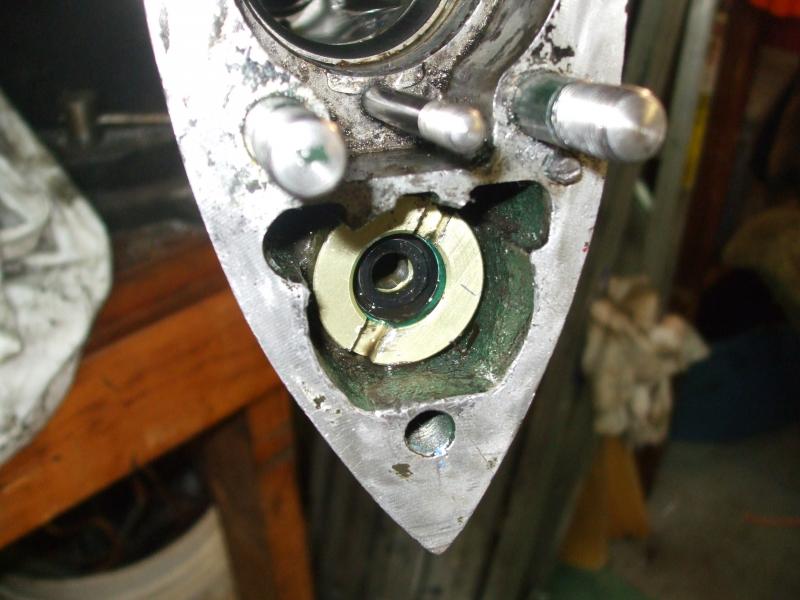

Finally got the time to take L/U down everything looks good .I'm not sure how much wear and tear is on the pin and cam posting pics of everything I have.Also in pic 1 what is the secret to get the brass bushing with seal in it.I need to get it out so when I put shift back in I have to put c-clip back on.shift lower cam 001.jpgshift lower cam 2.jpggears lower unit 001.jpg

Hi mitch_houser,there is a special tool for that job,or you can make one.Sierra 18-9817 SHIFT SHAFT BUSHING TOOL Replaces Mercury part # 91-31107T,here on this site.Hope you kept the shim material in order for putting back. The corners on the dog look a little rounded.Cam looks ok,new one is about $20. Happy Christmas and prosperous New Year.

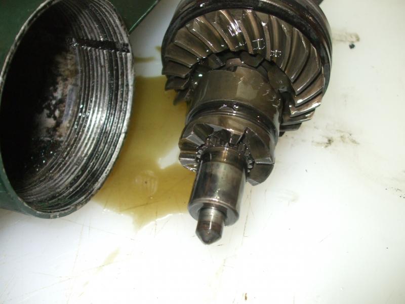

The edges on the tooth of the clutch dog should be sharp,yours look a bit rounded on the reverse gear where the dog connects. The ramps on the cam look ok,be sure when reinstalling that the numbers are facing up,just like in the pic.,and the ramp should be in the forward position.Rounded end on your right,putting the longer side of the ramp to your left as you look in.
I have tried to upload pics of worn dog and reverse gear from 1969 Merc800 lower unit,should be the same.

Thanks for the pics and info.in the process of making tool to get seal out useing 1/2 in drive socket and 7/16 allen wrench spot weld here and there viola.I was looking closer at the gears the one with all the stuff still connected is that F or R gear?it looks worn on edges bad
Sorry, meant to to say,that is your reverse gear attached to the bearing carrier your pic. My pics aren't the best.Whatever way I resized them,they seem to have gotten elongated,not very handy on a computer.

I looked at the pics on your other post. The cam looks good.The gear,reverse,looks chewed where the dog meshes.See the tops of the two teeth visible are worn looking.
Were there any metal bits on the drain/fill plug when removed? The dog is out of focus so can't really see it properly,but if the gear is chewed then the dog isn't going to be much better.
I did notice that your clutch is slightly different to my pic but the same principle applies.
Jeff was asking if the cam follower goes the whole back,it needs to go to engage the reverse gear fully.Otherwise it will not catch fully and slip out of gear and you get the wear on the teeth like in the pic.When it is stripped out this far,it might be the better option to replace both the clutch and the gear.Or take both to a shop and compare the wear with a known good clutch and gear.A few on on Ebay http://motors.shop.ebay.com/i.html?..._osacat=26443&bkBtn=&_trksid=p4506.m270.l1311
