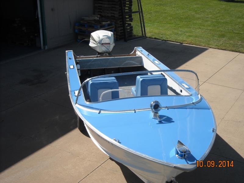

I have a 1960 Starcraft Jupiter with an '66 80hp Evinrude. When I hit approx. 3/4 throttle the front end starts to go side to side and I have to throttle down to maintain control. Picture shows how it's sitting now. Prop say 14p and is approx. 9" in diameter. I appreciate any help. Thanks

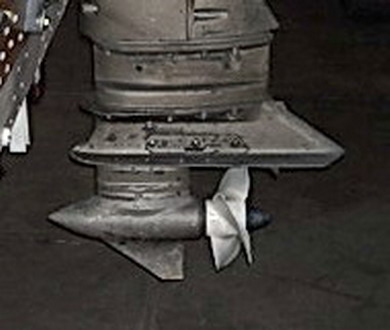

The engine/cavitation plate looks to be about perfect... you might try placing the angle setting rod in more hole just to see what effect that has... BUT... that will probably cause the bow to plow which of course is something you want to avoid.

If I'm right, and we are talking about the same boat, it's rated for an 85, so it's not overpowered. Looking at the pic again, I think the motor may be trimmed in too much.. I'd try raising it one hole and see what happens.

thats not a whale tail on that motor but there is some type of tail bolted on it...i would remove it and try it...
A tail won't affect the boat if it's chine walking, which I really doubt. You say the bow goes side to side. Can you give a better description than that? Lets start with a couple of definitions.. Porpoising is the bow going up and down, in a pretty steady motion. Plowing, the bow is trying to go underwater. Chine walking, the boat is rocking side to side. That hull won't chine walk, you need to have a V hull to get that, and the Jupiter has a flat profile at the stern.

saw that joe but re asked anyway...i dont think we know whats actually happening with the boat...i have never saw a whale tail on the market built like that either...if that boat is trying to come out of the water and fly there is no telling what will happen...
I edited that lower unit and see nothing attached to it (below). I wonder if the lower motor mounts could be broken and if so, that engine would move quite a bit within the housing... in turn changing the angle of attack.

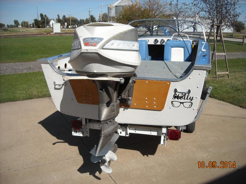

The boat was chine walking like was described above, so I trimmed it out one hole(middle hole of 5) and tightened the steering cable. Now she cuts through the water smoothly at full throttle. I removed the lower end and pressure tested it and found it was leaking around the shift cable assembly. Someone before me must have removed it and it wasn't pulled through enough to make it seal. I don't think these are made to take out and put back in but with some effort I got it back in. After having it out on the lake the other day I then drained the gear oil(Type C) and no signs of water. It's a blast to be on the water especially with a classic boat. I'm getting a lot of looks and compliments Thanks
Boat-5.jpgBoat-6.jpg Here's how I have the 1960 80hp Starflite trimmed on my 1960 Starcraft Juptier.
