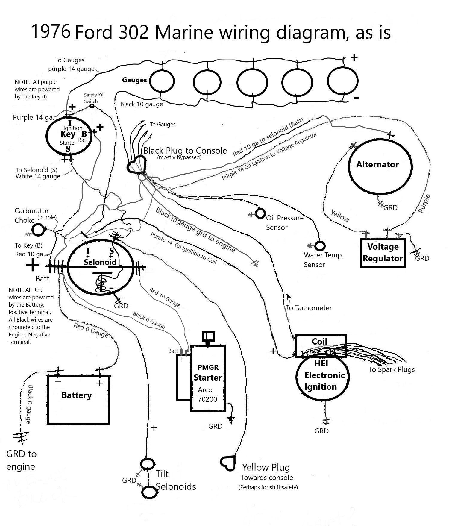

The directions on the new starter said that the new smaller starter wire on the selonoid (S) terminal should be the only wire on that terminal, and we still have that wire that goes through the yellow plug towards the console. I have disconnected it before and seeemed to have no effect upon anything. I did check the tilt and it worked. The only thing I didn't check was the shift (may need to be running). It seems the tilt selonoids get their power from the Battery terminal of the selonoid, and I think the shift does as well. All the wires from the remote control goes towards the back in that area, I believe through the yellow plug. Should ground it to the engine, just cut it off or insulate it?
What else would need to be powered just when you turn the starter????
My mistake, the small wire to the starter is the only wire on the big starter terminal, but we still have the other wire on the (S) terminal that goes towards the yellow plug. But it still is a mystery of what else would need to be powered up when you turn the starter key.

On the yellow plug, I'd be inclined to tape its wires up for right now.
No real mystery as to what needs to be powered...the solenoids are the main items, the ignition 'assist' may or may not be needed, depending upon the ignition system used...with a three terminal slave solenoids, that is OBE...
On the yellow plug, it may be tied to the shift assist (ESA??) scheme that OMC has used...I honestly haven't messed with enough to remember when they get used and on what applications...may be worth looking into that one more...
