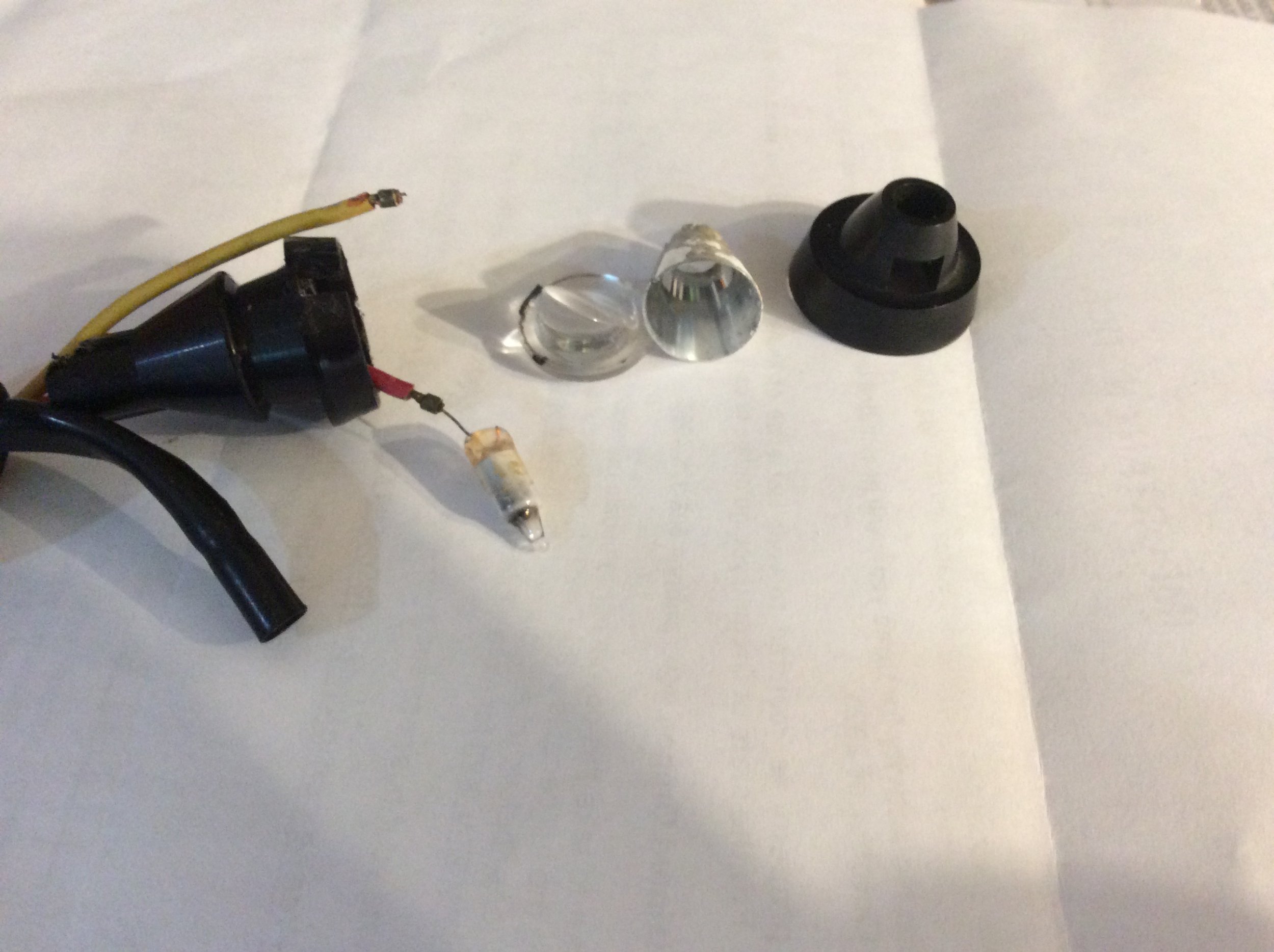

"Got an early model BF75 (late 70, early 80) with no oil pressure lamp and loud mechanical type noise. After removing the cylinder head found that the o-ring between the cylinder head and block for the oil pump was not there. I replaced it. Now I get the oil pressure lamp on at midrange and high RPMs. It's still noisy.
I'm thinking I got a bad conrod bearing (the knocking and lack of oil pressure).
Any thoughts or suggestions."
