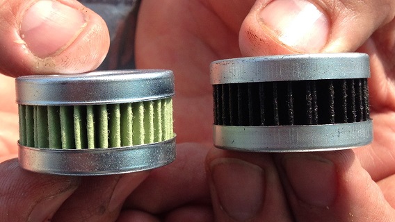

The high pressure fuel filter in the VST was filthy - thick coating of black residue so I'm guessing that was the problem, fuel starvation.
I'm amazed the HP fuel filter is so small and no wonder it gets blocked so easily. Its a teeny little part.

Just out of interest, I thought I would add a pic of the comparison to see just how dirty it got.
I have been using regular pump fuel in a clean tank and no sign of any contamination in the tank so the dirt must be just small suspended solids in the mix.
Sorry, its been an age since my last manicure...
