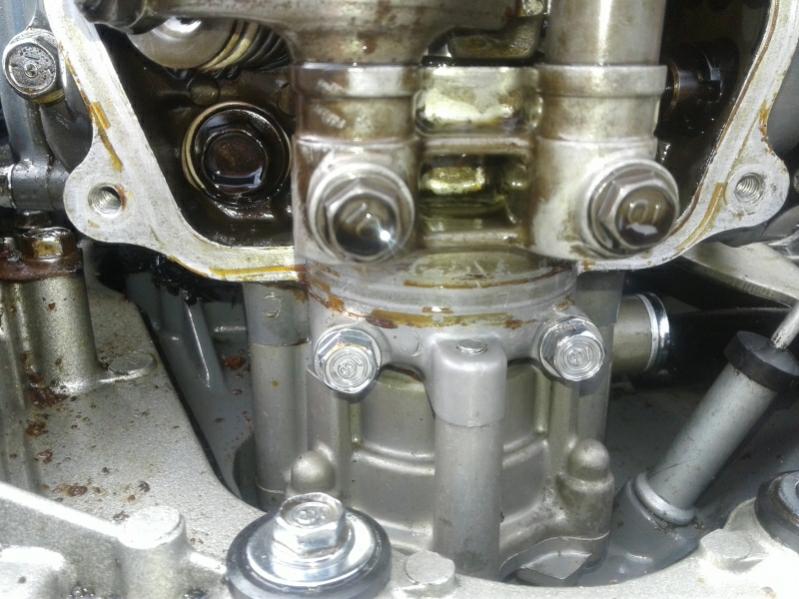

I have a engine Oil leak of about 20-30mls at the bottom of the inside by the oil pump
from about 1 hours running,
had the boat out only three times and cant see any leak yet
any ideas where they leak ?
thanks for the reply
Do you mean the exhaust valve to tight ?
I removed valve cover today to check/adjused intake/exhaust gap and re-seal the cover and its possible the gasket is leaking....maybe...
its still soft but I used some loctite master gasket 518
should have a chance to try over the weekend
