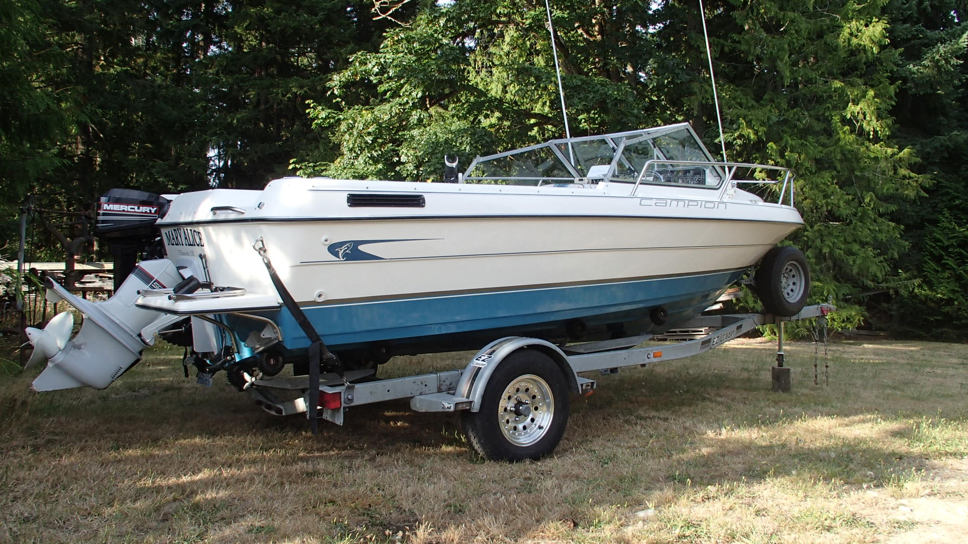

So I have read all 72 pages of this forum and learned a lot. i have a Volvo 131 or 230 with a sp-c drive that I have been happy with but I am thinking I would like to own a boat with a v8 and dual prop of the aq series. What is the opinion of a great engine/out drive for single engine boat about 21' fish/cuddy . I will include a picture of my boat I currently own and like the size of. I enjoy the waters of the puget sound.
And thank you to people that have knowledge that take the time to reply to posts like this, I really appreciate it! campion 008.JPGcampion 028.JPGcampion 002.JPG
That looks like a very nice clean boat and trailer. Those little OHC 4 bangers are great engines, and when treated well, will go for years and years.
As for the V-8 engine...... I would suggest that you first learn if this exact hull was ever produced with a V-8 engine that weighs considerably more than the OHC 4.

Thanks Rick, I should have phrased that differently, I do plan on selling my boat and looking for a different boat with a v-8. I will incorporate the dp-c drive into my search for a new to me boat.
