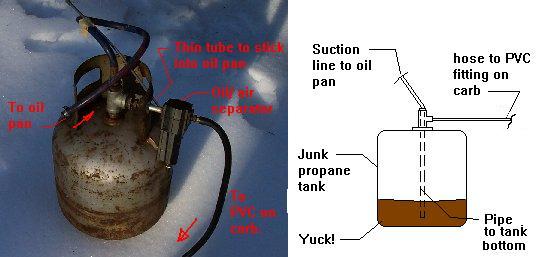

Which ever pump you use, be forewarned that the oil MUST be hot or you will not be able to suck it out!
Jeff
PS: Just did both engines with my homemade rig. Cost was about 10 bucks. I use an old, now illegal propane tank that one can get for nothing. Since I have twins, I use the vacuum from one motor to suck the oil out of the other one (then switch engines. With my old single screw boat, I used my car for the vacuum function.)
Jeff
PS: Just did both engines with my homemade rig. Cost was about 10 bucks. I use an old, now illegal propane tank that one can get for nothing. Since I have twins, I use the vacuum from one motor to suck the oil out of the other one (then switch engines. With my old single screw boat, I used my car for the vacuum function.) The oil/ air separator (shown in the photo) was found to be unnecessary and removed. Oil comes into the tank via the center via a drop tube that goes to the bottom; the side fitting is where air is sucked out of the top of the tank. Works slick!
Jeff, it sounds like you must fire up a second engine for the vacuum source, and that it would require removing the plumbing in order to drain the oil from the propane cylinder.
Wouldn't it be much easier for you if you purchased a $55 Oil Boy, or equivilant?
Don't get me wrong..... I like your enginuity.
The tank holds all of the oil, which I remove later, at home, and at my convenience. And plugs placed in the hoses keep it from leaking into the trunk of my WIFE'S car.
Since you have to warm the oil anyhow, the "vacuum pump" motor is being warmed up as it sucks out the oil from the othe motor.
Jeff
PS: Another nice feature is the system's ability to suck the oil out of the old filter, and the drain pan that goes below the filter as it is unscrewed.

Jeff,
I was looking at your picture and drawing...is it possible that the oil can be drawn into the carb or is there a separation between the in and out "t" ? OR, is that the job of the separator attached to the "vac" line?

Knuckle, I think that Jeff's "dip tube" (aka pipe to tank bottom tube), and the fact that his suction occurs up high, is what actually prevents any oil from entering the vacuum supplying engine.
If his tank was to become full, then yes..... that engine may pull oil in.
Maybe that's how Jeff fogs that one engine! :D :D :D
To be honest, I once stupidly hooked the wrong hose to the vacuum pump motor and boy did it smoke! Normally, however--meaning, when I'm paying attention--there's no oil is sucked through. (That's why I was able to eliminate that air/ oil filter.)
All in all, a very effective system that has been copied by many delighted boaters! Should have pattened it.
Jeff
PS: The tank is less than half full with all 12 quarts of oil in it.

You know, Even though I did read the caption that the pipe goes to the bottom of the tank, my brain saw the dashed line and made me think "path of free falling oil"....duh !
Well, then I have my answers. I know I no longer have one of those tanks but can you remove the valves from a newer style and go from there or is there a known reason that won't work?
Ayuh,.... The 20lb. propane tanks are pretty much all the same, just under 5 gallons, 'n a 3/4" pipe threaded hole...
The ole non-opd valved tanks are a dime a dozen around yer local trash place or scrap yard...
