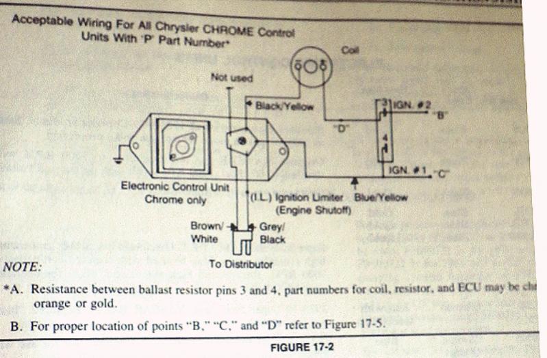

I have a 225HP Chrysler 318 with electric ignition that I would like to start on a bench? Does anyone know how to wire it up for a simple bench start?
Not acceptable on the water. Should work for test stand I believe .........
Ayuh,.... Supply it water, 'n gas,...
Battery to the starter,...
A 12v jumper wire to the coil's (+) terminal, 'n jump the solenoid oughta do it,....
