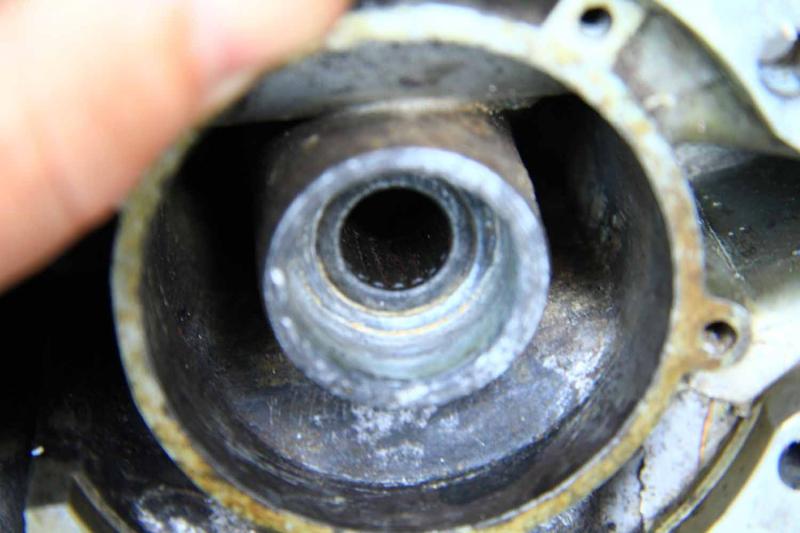

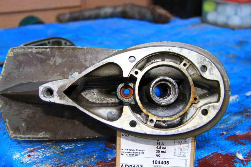

I removed the lower leg and extension and have purchased a replacement water pump kit - it came with a single lip drive shaft seal.
The orginal was a mongrel to get out - but I persevered and managed to get it out over a period of about an hour - without damaging the alloy housing.

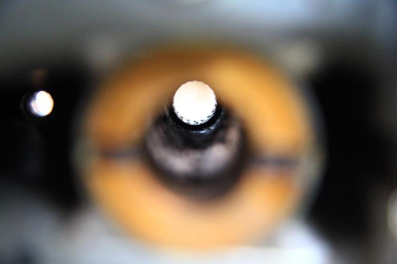

Below this, is a needle bearing - which is clearly spent... it is rusted (sign of water leaking past drive shaft seal) and the needles are at a slight angle from vertical. I suspect that this bearing is to support the driveshaft against the load of the water pump impellor?
I have ordered in a pair of double lip seals which can be fitted into the housing on the driveshaft. There is very slight pitting on the driveshaft where the original seal ran... but there is wear on this shaft where it runs against the spent needle bearing.... I cannot get a replacement driveshaft (nor do I want to). I have rubbed out most of this pitting using wet and dry.. but there is a small amount embedded in the metal.... I do not mind replacing the gearcase oil after each trip (considering the motor is used perhaps once/fortnight in an "out and back" fishing trip).

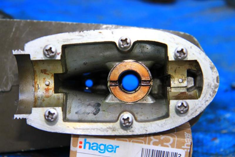

The propellor shaft bearing retainer seal is also suspect... I can get likewise replacement double lip seals to replace this.
The propellor shaft is also slightly pitted.. again, I have rubbed most of this out - it will wear the seal eventually - and I can easily get replacement seals...... removing and re-fitting them is my issue.
I have a replacement shifting shaft seal.
