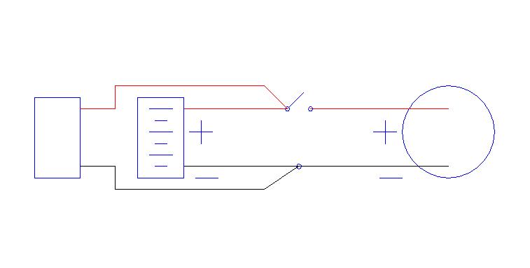

Would it be safe to attach a mains power battery charger to a battery installed on a boat while it is still wired in but isolated from the outboard motor by use of an open switch? I don't intend to permanently wire in the charging unit, just trying to make it more convenient than removing the battery from the boat after each use.
Charger / Battery / Outboard (starter motor)

I might look at removing the alligator clips I currently have and replace them with eye terminals I can attach to the junction points on the diagram above. The cable from the junction points to the battery is a lot heavier gauge than the charger output leads.
If you are using the charger when the engine is not running and the key off there is no reason for a switch...if there is a reason i been breaking a rule for 50 years...just dont crank the engine with the charger attached...if the charger is dedicated to just charging the boat then add a permanent pigtail to the battery and replace the clips in the battery with a matching plug or receptacle....trolling motor plug and receptacle works well but will cost you about 30 bucks..i have a emergency portable light that i put one of those plugs on...the other option is for one of the trickle chargers that Guyjg mentioned.. i am running 3 of them on a campboat for the batteries on aux stuff like the sewer treatment plant and bilge pump..they come with an inline disconnect plug that will do what you want..a word of caution here...if you are going to leave them on a battery 24/7 get the 1 amp one...1.5 max..i have had a 2 amp one that would eventually boil a battery dry...i do now rely on those type chargers to charge a trolling motor battery overnight..
