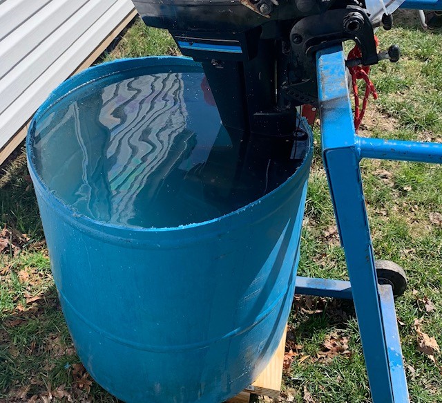

I have it on a stand and in a barrel. I have the gas tank on the ground. If I don't pump the bulb, and with the choke closed, first pull sounds normal but doesn't start. 2nd pull it tries to start for 1-2 seconds. 3rd pull it barely tries. 4th pull and on it sounds completely dead. If I wait 30 minutes the cycle will be exactly the same.

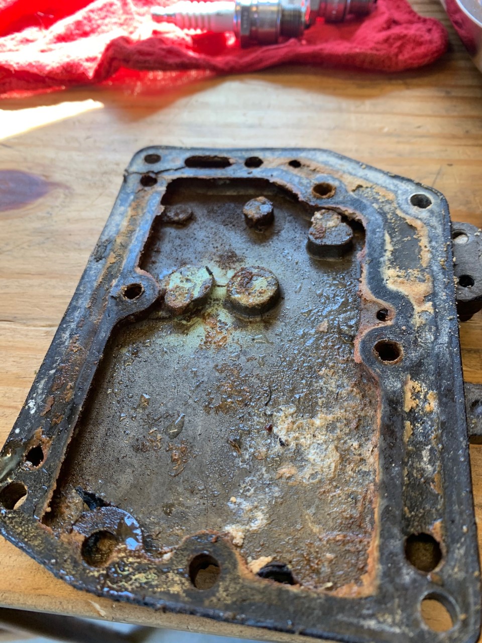

I am going to try and upload pictures. Most are of the condition when I got it. One is cleaned up.

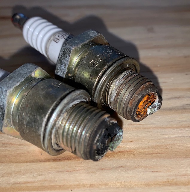

The spark plug appears to show rust.------Hopefully the engine internals did not have water sitting on them.---Does spark jump a gap of 3/8" or more on both leads , yes or no ?
racerone, the spark plugs did jump no problem.

I have it in a barrel of water, I ran it for only about 20-30 seconds. No water is coming out of the pee hole but a strong stream of "steam or blueish steam" is streaming out of it.

Perhaps plastic water at top of water tube is damaged.-----Or you need to put more water in your test bucket ( 8" above the pump ) is how to test.
Before I would put a penny in that engine I would find out where that water came from on that rusty plug. Was that engine run in salt water that you know of?

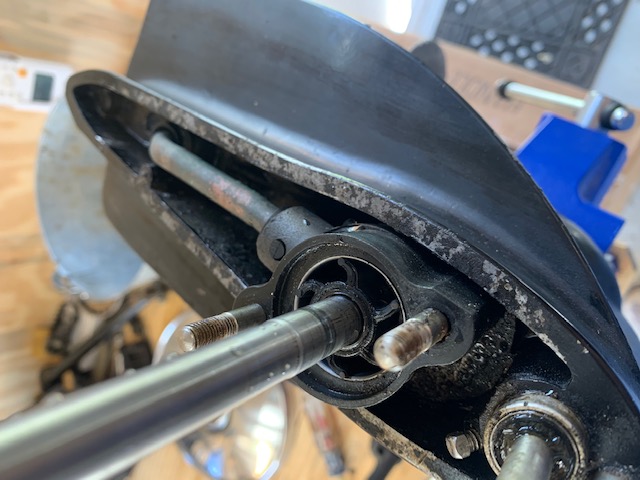

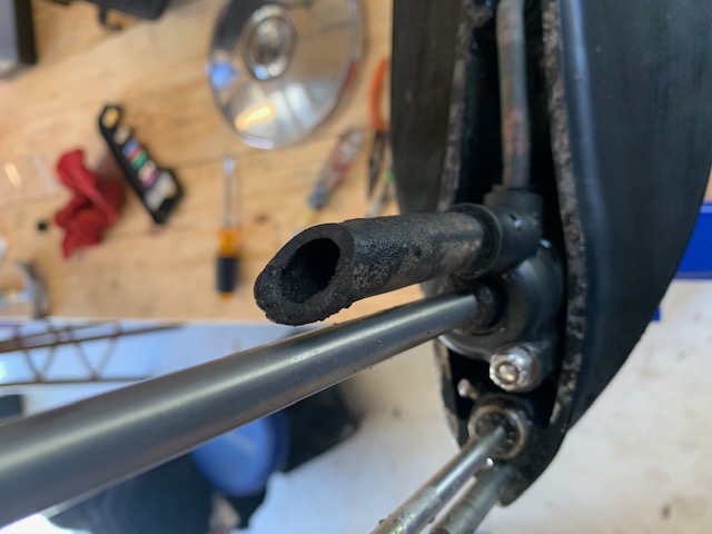

I have replaced the impeller and the tube rising from the impeller housing. I have made sure the tube from the inlet to the housing is clear. I have blown air up the long tube and felt it coming out of the tell tube. I can not figure it out. Starts great now, but no water through the pee hole.

Pictures of the old tube and new impeller.
Ken

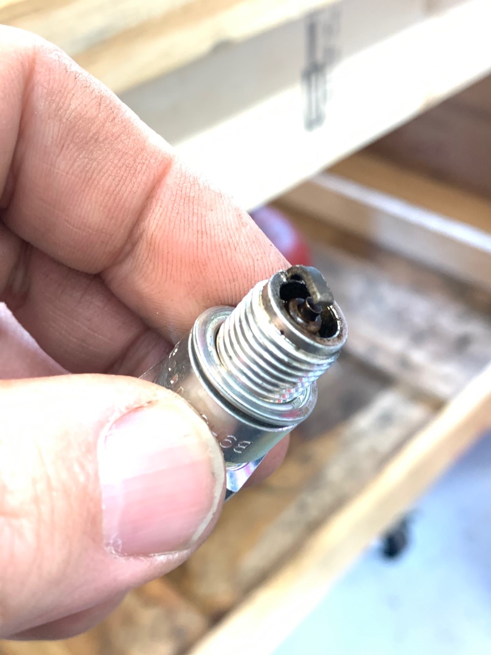

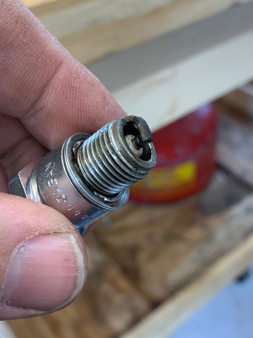

Did you ever find out why that sparkplug had rust on it? Check it again and see if one of those plugs has water on it. It may be part of your not pumping problem.
BigJ, I have not figured it out.
Ken

as per previous comments, the water pump needs to be primed -water level needs to be higher than it normally would be to help the pump fill up. Be sure to fill bucket right up to 8” above pump. Also, in case you haven’t figured this out already don’t keep running it without water flowing you’ll need a new impeller if you don’t already!
Remove the LU and sit it in a bucket of water. Attached a drill
you should see water coming out of the plastic tube.
be sure water height is just below the top of plastic tube.

Fitz - I don't know why it was rusty other than 7-10 years of sitting. I did what you said, below are picture of both spark plugs right after I ran it for 20 seconds or so. Maybe I am wrong but I do not see water.
racerone - I am not sure exactly what I should be looking for at the top of the tube. Below are pictures of that area. I know I didnt get in there for a great pic, but what should I be checking there?

I do not see a picture of the top of the water tube.----So find out where the water tube is and goes.----Not in your pictures here , so can not help.
