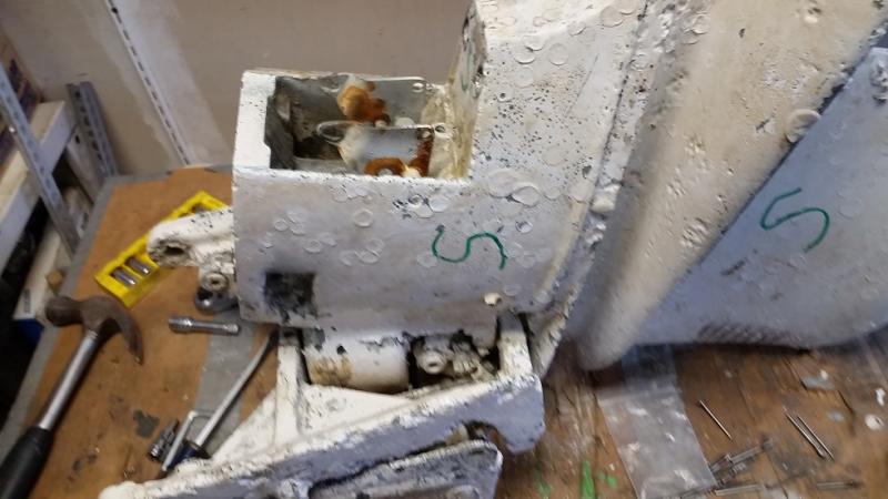

Hey Folks,
Need some help here. I am rebuilding my two outdrives and need to remove the lower unit from the intermediate housing. I have removed all the bolts but I still cannot get them to split. I have rubber mallet-ed the heck out of them. Then tried a cold chisel at the seam but I am only succeeding in beating up the cases. Does anyone have any magic here that will help?
Is there a solution that will break the aluminum corrosion? am I missing something here. I will not be reusing the cases as they are really in bad shape.
Thanks in advance.
Kevin

Kevin, have you removed all of the fasteners?
There are 4 vertically positioned 3/8" cap screws that face UP, and 3 vertically positioned 5/16" cap screws that face DOWN.
Be sure to apply heat at/near/on the area of the 3 - 5/16" cap screw threads.
DO NOT drive anything between the cases. Bad Ju Ju!
Yes..... patience, experience and heat (small Propane or Mapp gas torch..... NO Oxy-Acet )!
Yes.... complete replacement!
Your drive compoents are severely corroded. I would be replacing all of that.

I got my MAPP gas torch out. Heated it up real good, then gently dropped the lower and intermediate to the garage floor from about a foot up. This sudden shock was enough to break it free.
