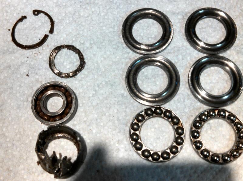

Forgot.
Here is a pic of the battle damage!
When i get the other bearing i will post that number also
One thrust bearing is slightly rough. The other is fine.
That piece is the spacer bushing. Can't remember the name right now but it was stuck so i had to chisel it out..
Ohya its all back together now and working fine. Quiet now no coffee grinder sound.
