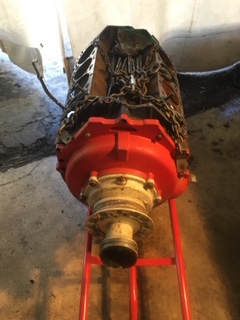

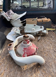

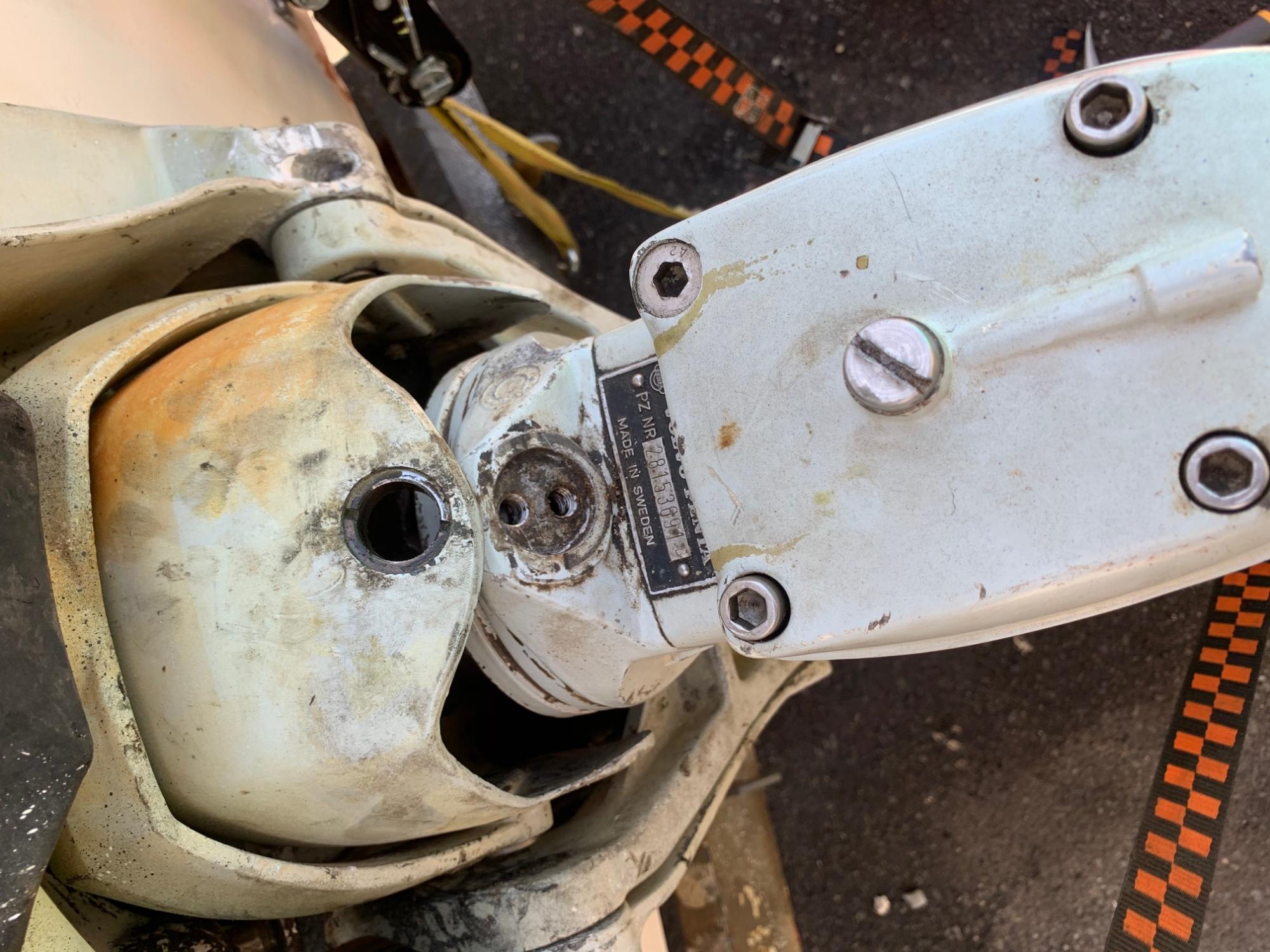

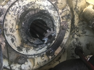

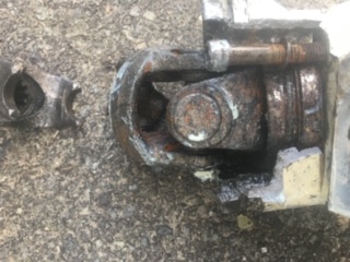

Coming home from a day of fishing at around 26kts the drive shaft busted at the u-joint and created some havoc in the drive area. The spinning shafts shredded the bellow, cracked the casing of the transmission, destroyed the flywheel cover from the clamp ring back, and when we began disassembly the oil was contaminated. Here are some pictures of the carnage
