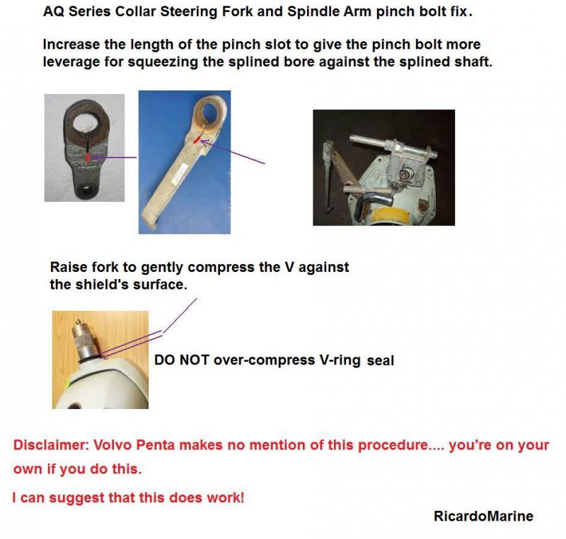

The spindle arm incorporates the Port/Stbd steering stops..... not the collar steering fork.
If a person was to re-install the spindle arm onto the collar steering fork while being one spline OFF, it will cause un-equal Port/Stbd stern drive articulation.
While Volvo Penta will NOT suggest this....... their spindle arm "pinch" slot is too short. Often the pinch bolt will not clamp/squeeze the splines onto the fork with enough force.
The cure is to increase the length of the pinch slot some, giving the grade #8 pinch bolt a much better advantage during the clamping/squeezing process.
(see images below)
