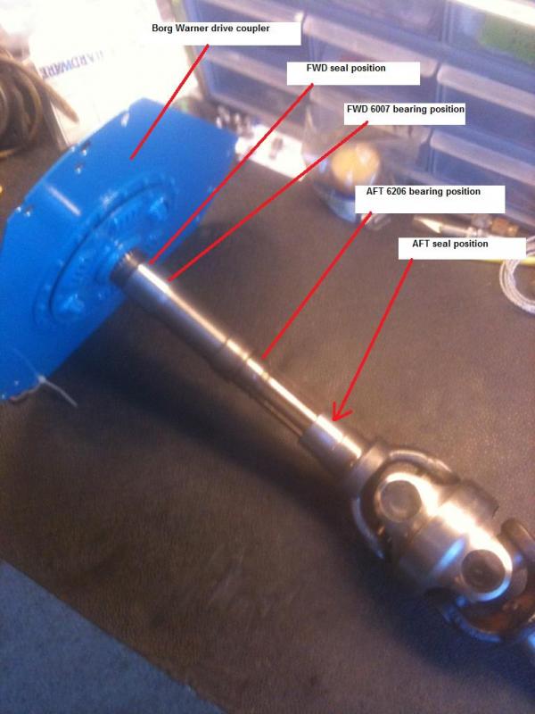

Also, I'd strongly encourage you to replace the PDS bearings while the engine is out.
The engine must be out in order to access the double bearing PDS, of which I'm certain that your flywheel cover is using.
For about $45 you can buy the two bearings and the two new seals and a tube of proper grease... not green marine grease, BTW.
Takes me about 1 hour to do this job once the transmission is out of the way..... of which it shouldl be for service work and bellows replacement.
This will prevent you from the destruction seen bellow.... when/if the rear bearing fails.
BTW, if the mechanic removed the flywheel cover with the engine, you'll want to replace the inboard rubber ring.... (aka rubber cushion).
This cushion provides the water seal between the flywheel cover and transom shield.
(the old cushion will have taken a set by now, and may not re-seal)
