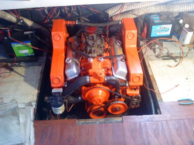

I have a Volo Penta AQ20d. It is raw water cooled. When I start her up there is plenty of water pumping from the sterndrive. Problem is when it gets up to operating temp (around 140 degrees) and put her into idle the water stops pumping through the sterndrive aout 850 - 900 rmp. If I increase the revs the water starts pumping again.
I have changed the impeller, thermostat, checked all the pipes, checked the circulation pump (no broken fins or leaks) Taken off and cleaned the manifolds and risers.
At a loss what to do next. Any help much appreciated.
