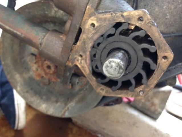

If I am right there is no water pump/impeller in the sterndrive itself on this engine, but it is mounted on the engine block itself (Took me some time to figure out). Now I checked if the water pump was still functioning by disconnecting the intake (Which goes to the sterndrive) and connected a tube on it which I then holded in a bucket of water. No suction at all...
I then checked the pump house and impeller and couldn't find and problems!
The impeller was in a good condition so I really didn't know where to look further
