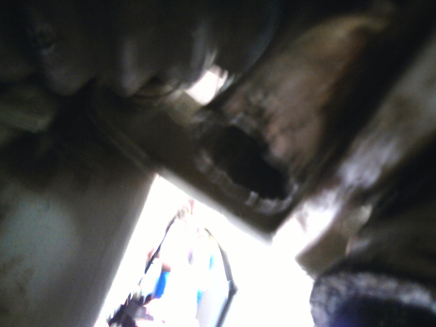

removed suction hose and where it hooks to outdrive looks bad and probly isnt sealing

Either one should work, but the 18-2777 has a slightly narrower neck if I recall correctly.
The drawing for the AQ131D/275 shows the 18-2778 as the correct fitting.

i have already bought and installed the 18-2778, contacted the dealer i bought it from and i cant return it now that its been installed. Do you think the 18-2778 will be ok?
If you look at the drawing in the link I posted above, you will see that the connector has three holes on each side, which is Sierra part 18-2778. In any case, it should fit your 275 with no problems. Just remember to apply a bit of Perfect Seal or similar (Aviation gasket, loctite sealing compound, etc) to the area of the water neck where the hose attches; this will facilitate the hose assembly and the coating will further protect the hose connector from stagnant water.
Ok thanks, Illl take you word for it, you seam to have alot of knowledge on these motors and outdrives. thanks for your help
