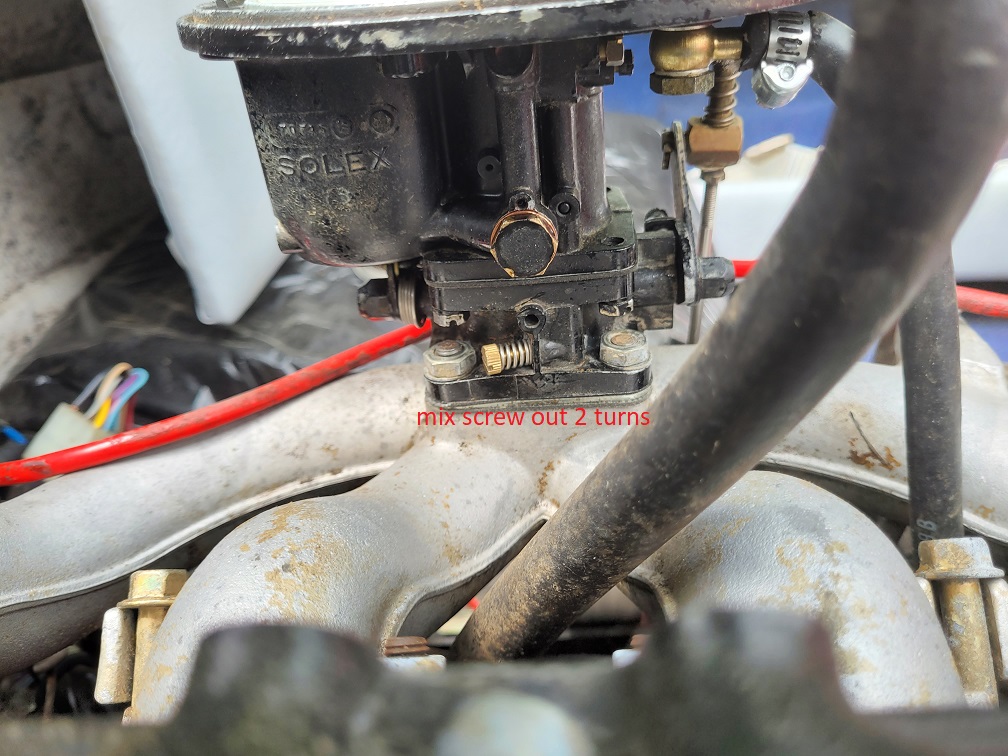

I turned the mixture screw in 2 turns and this is where the confusion starts:

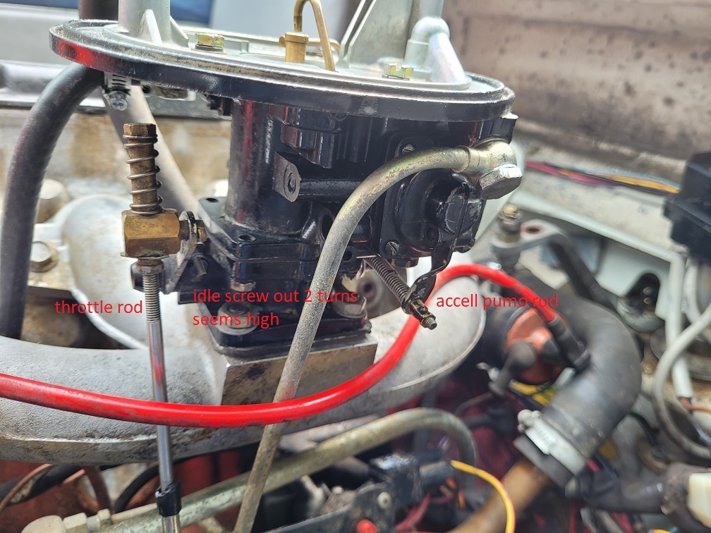

The diagrams I have found clearly show the mixture screws but there is no mention of the acc pump screw setting or the throttle cable setting and these may be causing problems. The "idle" screw, connected to the accell rod assembly, if I am correct, also seems way too open when I turn that out 2 turns.
I'm screwing something up here.
Pictures attached.

Ayuh,..... The 2 turns on the adjusting screws are just a starting point, not a final setting, which is done to get the best idle possible, usually by ear,......
Yep. I have tried in and out from the 2 turns but i am wondering if the other settings (throttle rod, pump) are off and throwing things off. If so, I can fiddle with the mixture screw forever and not get this running properly. the manuals have no reference to the correct settings for the throttle rod and pump rod.
The throttle rod is what sets the actual idle RPM, the mixture screw influences how smooth the engine runs @ idle so the kind of interact. The accelerator rod controls how much fuel is dumped into the throat of the carb when you want to accelerate (in gear).
O.K. I thought so but the setting for the throttle rod (the long one with spring) may affect the idle regardless of what you turn the throttle screw to. This is the initial setting I do not have. Similar to my motorcycle.. "adjust throttle cable so there is 1mm of slack before the throttle is affected..." for example.
Mixture setting is fine tuned by ear or set using a manifold vacuum guage. Throttle rod is the primary setting for idle RPM even thought the idle RPM once set will vary with the idle screw.... hence the gauge. You end up resetting the throttle rod adjustment again after getting mixture set.... assuming timing and dwell are OK.
