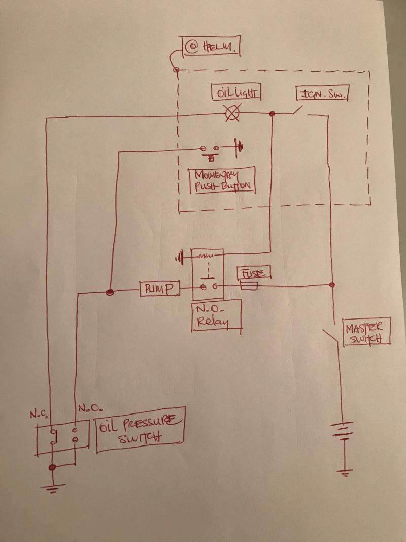

Understood - is it possible to buy an oil pressure switch that has two sets of contacts (1x NO + 1x NC)? I've just drawn up the attached schematic which I hope does what's been described but I'm thinking I need the existing oil switch contacts (that must be NC e.g. closed without oil pressure - for my warning light) and another set NO that will close when there is oil pressure to make my fuel pump run. Look OK? 171018.jpg
As you'll see I've already asked the guys to run the pump via NO relay contacts - because I didn't want the pump's additional current to pass through my existing ignition switch (and to give the pump it's own dedicated in-line fuse and have a good supply voltage due to suffering almost no volt-drop on its supply cables). Could the momentary (NO) push-button be located not at the helm itself? To have it there would be convenient but I'm struggling to think where I can put it. And, if it's only ever pushed for a few seconds to ensure the float bowl's full I'm wondering if it go elsewhere (kinda hidden away)?

The N/O LOP Switch will be two pole. (not same as what you show in your drawing) In other words, it will close a Positive current circuit, activating the pump's relay once closed.
And yes... if a "Start-bi-Pass" system is not used, the Momentary switch would be at the helm.
One push or toggle of the switch, and the fuel pump relay would be triggered for as long as you held the switch closed.

Hi, bit confused - you've said "The N/O LOP Switch will be two pole. (not same as what you show in your drawing) In other words, it will close a Positive current circuit, activating the pump's relay once closed." Confused - because that is what I've shown. One pole is N/C (no oil pressure = closed to earth down the oil pressure warning light) the other is N/O (only closed when there is oil pressure to earth down the pump for it to run). I could use this contact to earth down my control relay instead if tbe LOP switch contacts can't handle 5A but would prefer to earth down the pump itself so that the LOP is acting directly on the fuel pump itself. But do they make the N/C + N/O switch? Do you have a diagram of one you' e done?
And yes... if a "Start-bi-Pass" system is not used, the Momentary switch would be at the helm. I was wondering if USCG secify that it has to be at the helm or could it be positioned elsewhere and still comply?
