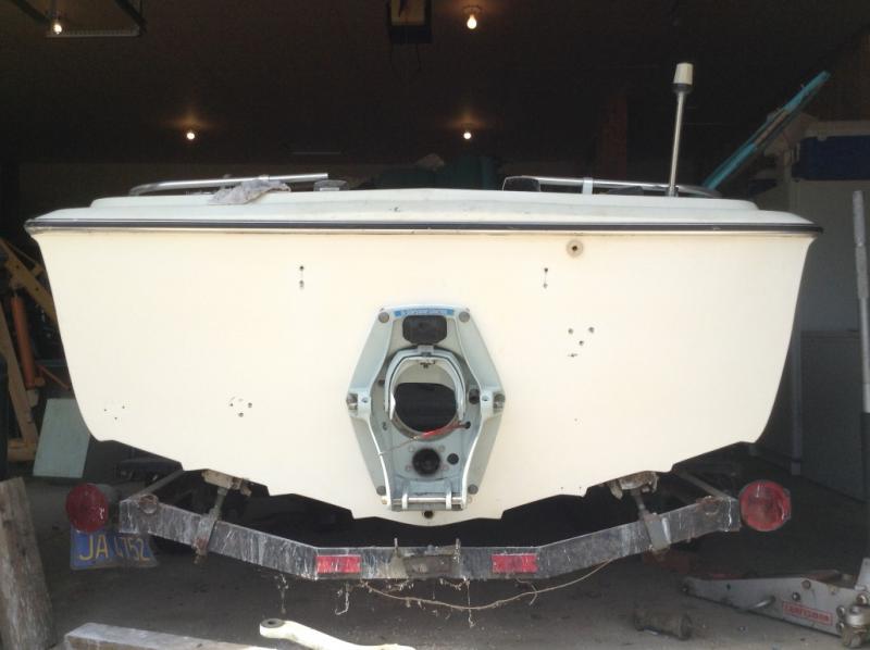

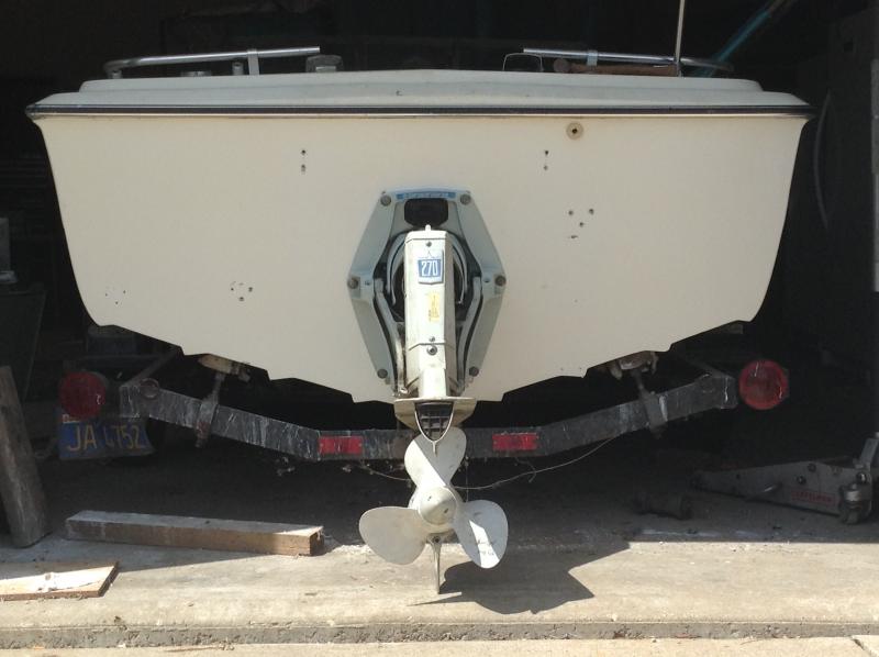

We put the transom shield back on today, using the original holes in the transom skin as a guide, but now that it is all sealed up and bolted tight, it looks like it is mounted slightly counter-clockwise on the transom, maybe an 1/8 of an inch out. Is there any reason that it would have been mounted that way originally or did we actually get it on there crooked? We drilled the holes in the same spot, the bolts fit the holes well, and it slid right in place without any of the bolts binding like a few holes may have been askew. I find it hard to believe we drilled 6 holes that were so misplaced that it would have bolted up an 1/8" out.

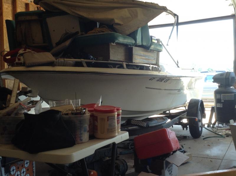

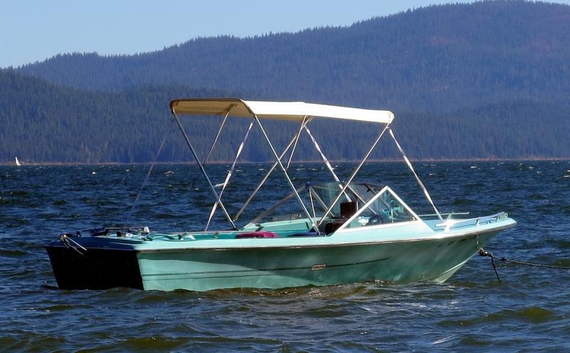

Sure, here you go. My dad bought this boat new in 1972 as a Father's Day present to himself and my family, He always took great care of it and he gave it to me about 20 years ago. I repowered it with a rebuilt AQ130C shortly after. Other than new upholstery, carpet,a bimini top, and a few other things, everything is still pretty much like it was in 1972, including the trailer. It's still running very strong and has greatly exceeded my expectations (knock on wood).

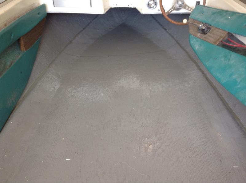

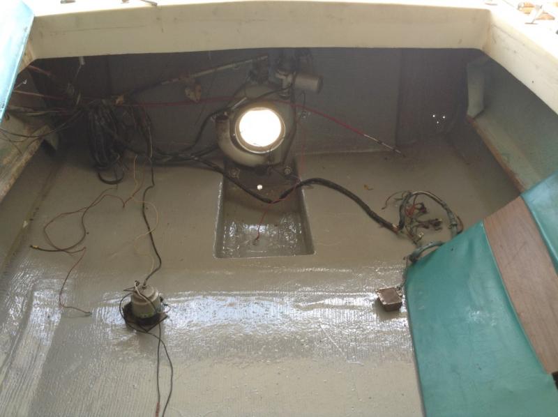

Here are some photos. Mostly buried in the garage with some photos I took of the new transom and floor.

Looks like some nice glass work good job. I doubt there will be any issues with keeping it the way it is it looks like the cavitation plate is real close to level. Ricardo will know better if you need to tweak it to make it perfect. My old carpet boss had a saying if you want perfect hire a guy named Jesús.

Thanks. I think it's an illusion due to a crooked rub rail. The rub rail doesn't follow the seam line very well. I just used the drain hole in the stern as a sight and I was looking directly at the centerline of the leg.

OK..... all kidding aside, it would bother me as well.
If not too late, pull the shield from the transom.
Try to round-file the 6 mounting holes in CW direction that would allow the shield to rotate CW until plumb.
Keep in mind that the "fat O-rings" create the seal at the carriage bolt "shanks".
These must become "compressed" and squeezed down on the shanks as the shield pulls tightly against the transom.

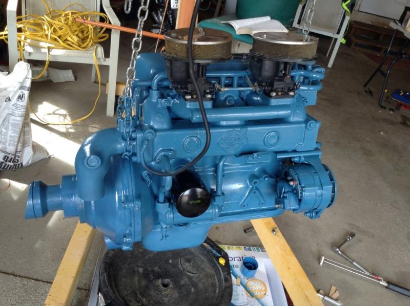

I did get the engine back into the boat today. I guess I'll have to unbolt the exhaust neck to put the rubber exhaust connector in place later. As far as everybody's recommendations go, I did chamfer the bolt holes in the transom for the fat o-rings. I put in a Pertronix ignition and coil a while back. I replaced the PDS bearing and seals and filled it up with grease. The crank pilot bearing and damper plate were in good condition. Have new bellows to put on. Still have to get to the u-joints and the plumbing...
Here is a photo of the engine from this morning. Hosed it down with Super Clean and a pressure washer and sprayed it with Chrysler Blue engine paint.
