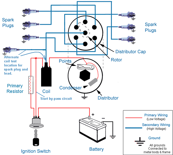

Basic coil showing primary and secondary windings.
Basic mechanical contact ignition triggering.
