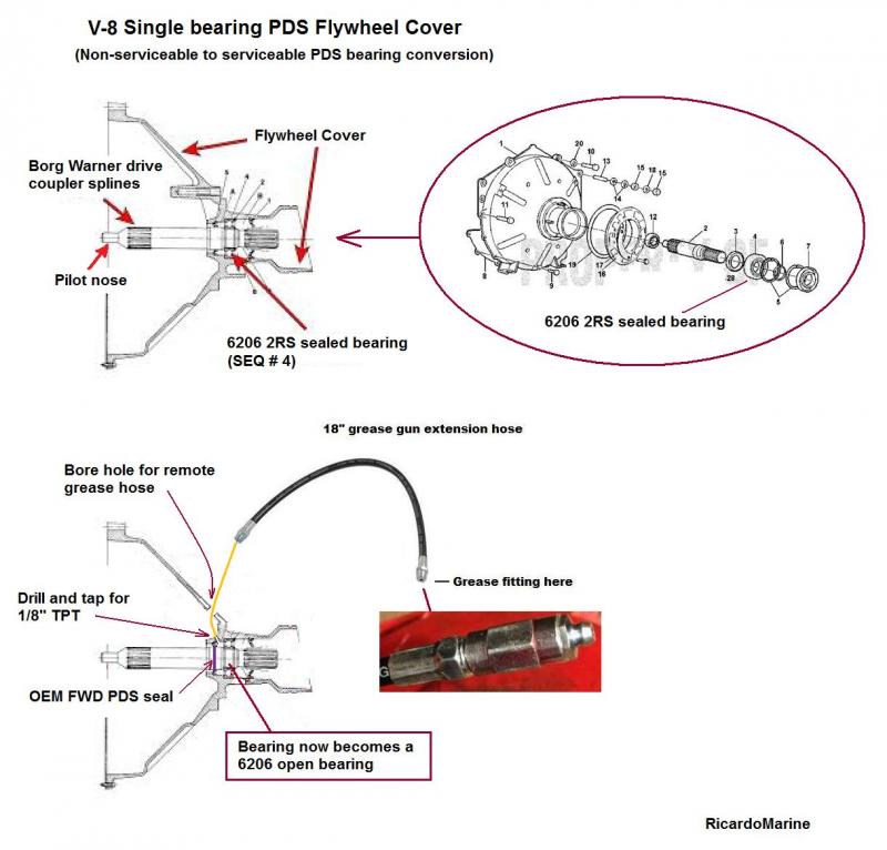

Bill, the first image below is of a later model V-8 single bearing PDS flywheel cover. It will be similar to your OHC 4 cylinder F/C.
I use this to show how to convert from non-serviceable sealed bearing to an open and serviceable style.

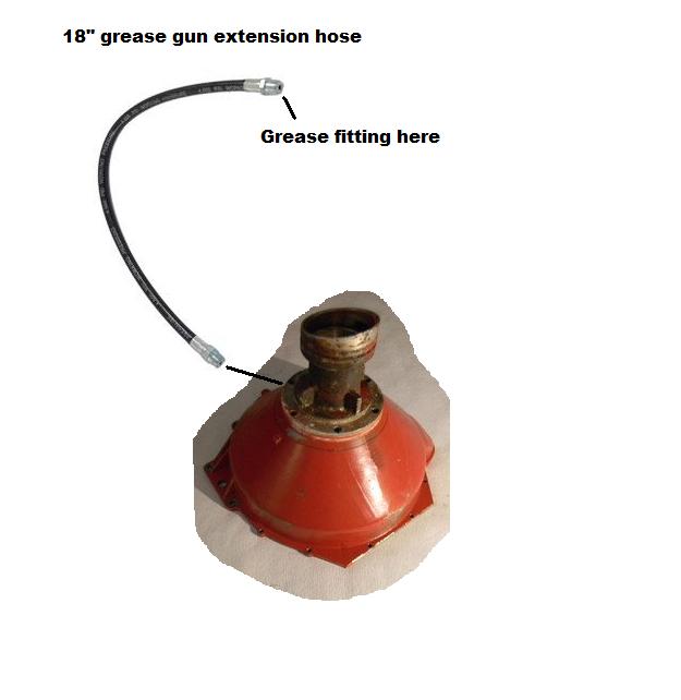

The second image shows a V-8 double bearing PDS with the grease gun extension hose w/ zerk fitting. You can do the same to your F/C if you'd like to.
I'm using these for an example only.
